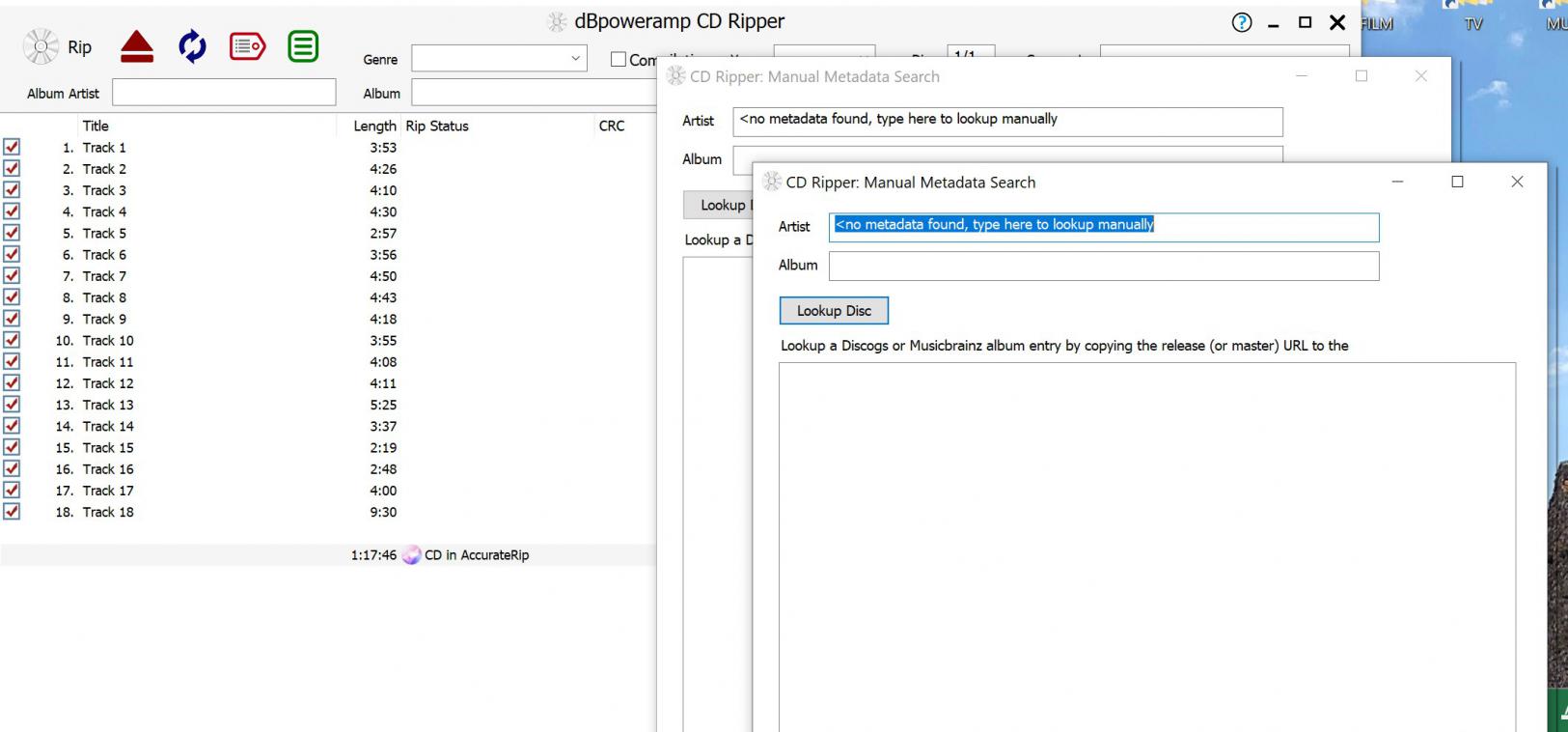

    CD ripper reports no metadata available
    Hi, I have just updated to R17 and on 70% of albums, the program throws up two manual search dialogs saying data could not be found. On cancelling both, and refreshing, it seems the metadata actually is there. Can I put a second or two delay on those dialog boxes to allow the lookup to complete?

    Re: CD ripper reports no metadata available
    If you click the green options button >> active providers
    which metadata providers are enabled? do you have dBpoweramp reference or the Power Pack?
    Also on that menu you can disable the manual metadata search.

      Hi Spoon, Many thanks for getting back quickly.
      I just updated to R17.7 Fully licenced Reference. Active Providers; PerfectMeta, dBpoweramp Cache, Discogs, GD3, MusicBrainz and freedb. I did spot the tick for the manual search option so may just leave that off. I have disabled windows autoplay to no effect.
      I don't see this behaviour on my old laptop, running the same version. Your thoughts?
      Can you confirm, the program needs a press of the refresh button to list the tracks. I seem to remember from the old v14 I had that simply inserting a disc would bring up the listing, but that's not happening. Ta.
          Thanks, there's something going on with my setup here. Have tried uninstalling the old version and new, then reinstalling but getting the same behaviour. I'm ripping 500+ discs and finding all these bogus messages and refreshing very tiresome. I wonder if the guys at Illustrate have a proper uninstaller to clear out any rogue settings or registry switches?? Hullo, anyone from the company have such a thing?
                      Thanks for all your help Spoon and garym.
                      I have used the uninstaller/cleaner and the problem persisted. I found what is causing it, the program hates that I have two optical drives. Once I removed the power from the second one, the CD ripper behaved perfectly.
                      Spoon, I would like the inability to recognise which one of the two drives has a disc in it, to be addressed as the second, slower drive often is able to rip where the first is struggling.
