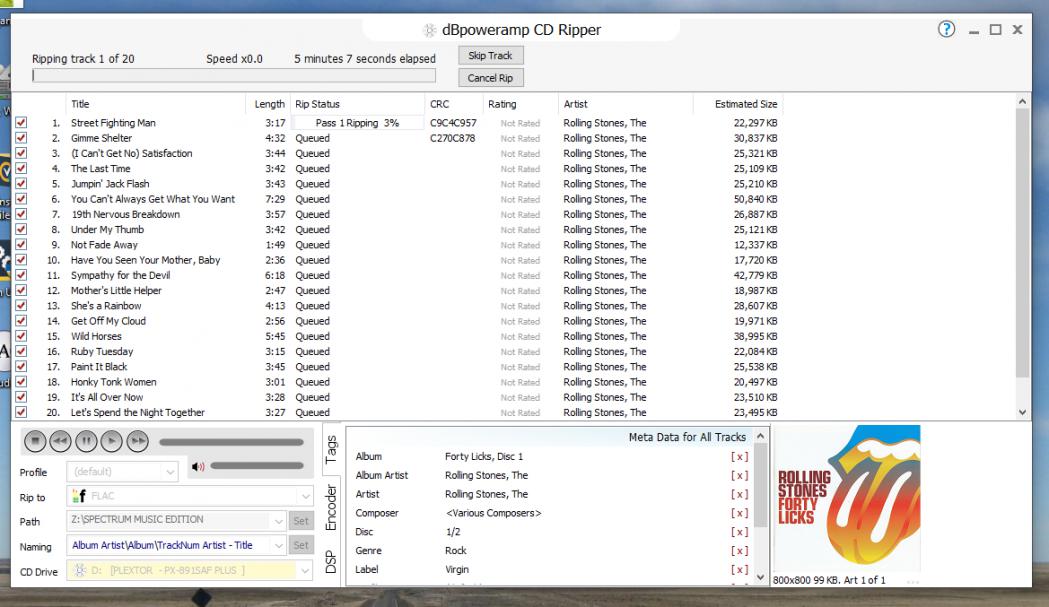

      Re: CD Drive doesn't start ripping
      I have tested the Plextor drive with EAC. It works without problems. If I'm waiting for several minutes after start of the ripping process then the rip status says "Pass 1 Ripping 3%" und the displayed speed is "Speed x0.0".Click image for larger version

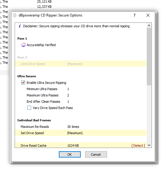

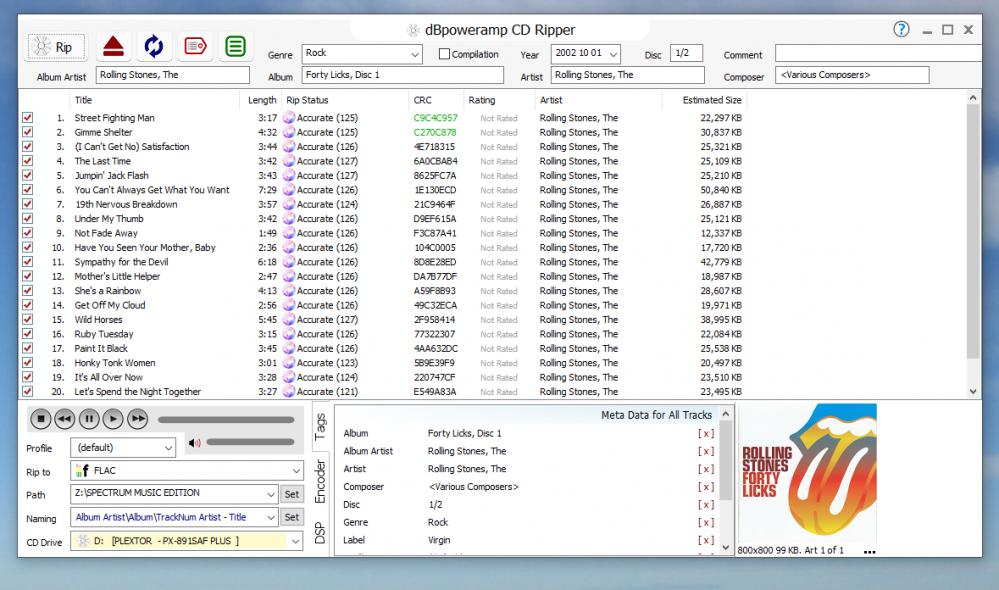

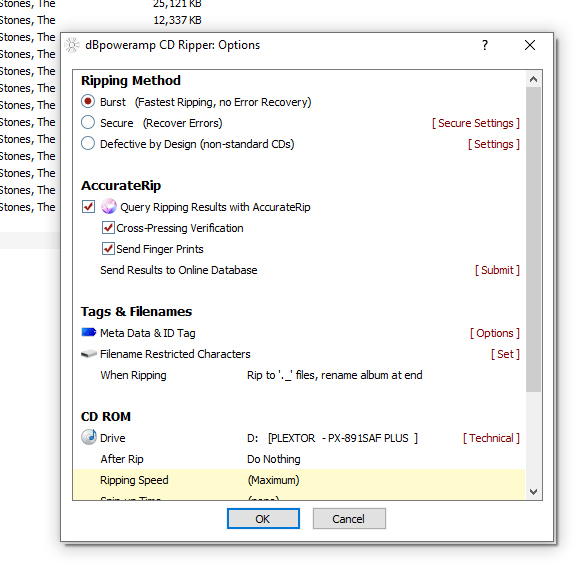

          After switching to burst ripping, you will find the result in att. 2 (apparently indeed a secure ripping). During observing the ripping process I could not recognize any encoding (CPU encoding xx%) after ripping of the individual tracks. In order to further inform you the current set up please find att. 3 - 5. Perhaps it would be the best to do a complete new configuration of AccurateRip for the Plextor drive. Is that possible?Click image for larger version

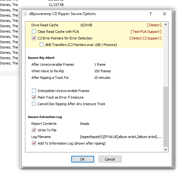

            Switch off C2 error pointers and try again.
            • whasberg
              • Dec 2021
              It works. Thank you.
