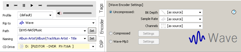

    Adding shot of my settings:
Name:	Untitled picture.png

      Re: Uncompressed Wave, Log shows different
      You are ripping to uncompressed wave.

          • 46160
          It reports the settings on the encoder page, which have the mp3 bitrate also, even though it is not used by the encoder in that instance.

              • 46160
              Because on one computer you went in the mp3 settings page within Wave and chose a bit rate, that value will then stick on the compression settings. The other computer you must have never done that.
              PCM is uncompressed, if it were writing mp3 then the files would be shown as Wave mp3 compressed if you hold the mouse over them and an average audio track would be 4MB, not 40MB as uncompressed is.

                Ok... THAT was a helpful response!!
                I did change the "Unused" MP3 settings on 1 pc & NOT on the other.
                Just tested & your right, it does stick to whatever is set, even though not used.
                It's strange but at least I understand what's happening. THANKS!!!
