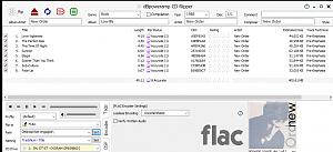

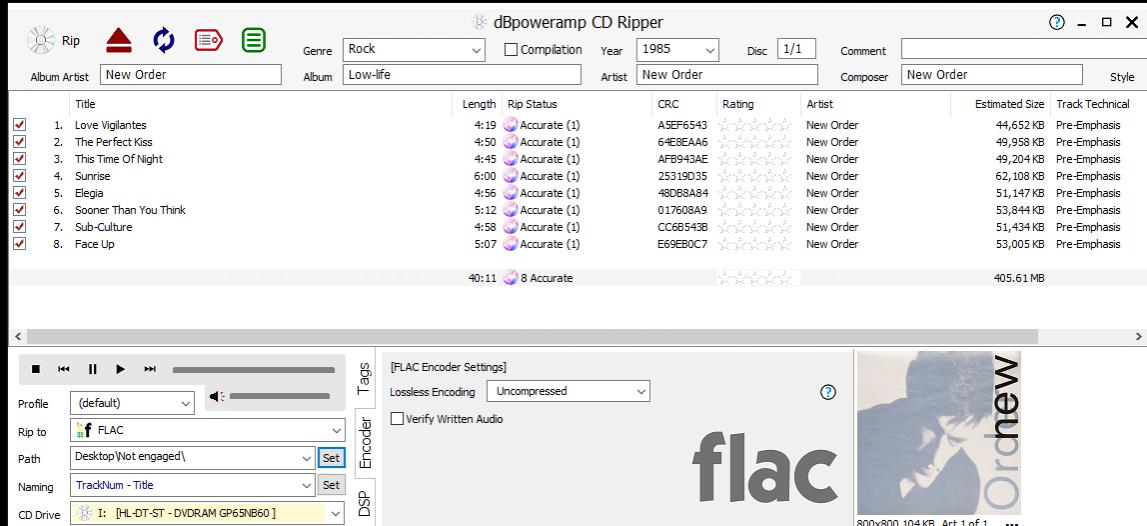

                          • c-eling
                            • Apr 2014
                            • 21
                            Re: Apply De-emphasis to CD tracks marked with Pre-Emphasis
                            Engaged
                            Not Engaged
                            Foobar PE Filter, vocals are usually the tell tale signs of pre-emphasis
