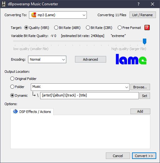

                      In CD Ripper, there's a Path field (bottom right). This would be your FLAC root folder.
                      In Batch Oonverter, there's Output Location, which would be where you set your MP3 root folder as Folder. You can't get to that to set it until you have selected your files to convert:

                        You have to use the "Multi Encoder". Once you have selected "Multi Encoder" you can add multiple encoders (like mp3, flac or what ever). For each and every encoder you have then to configure the output path and naming.

                          Ahh yes, of course, the Multi-Encoder would be far far better. Sorry, I've never used it forgot it even existed!

                            I read somewhere to set theoutput to Dynamic Naming and use Mp3\[origpath]\[origfilename]
                            This worked fine but meant me having to select c:, mp3, users, name, music, band name, album name....just to get to the files whereas to get to my flac files its just music, band name, album name.
                            Please forgive the lack of knowledge here but how can i send the mp3 files to open in a location under music?
                            Ex. Music, mp3, band name, album name
