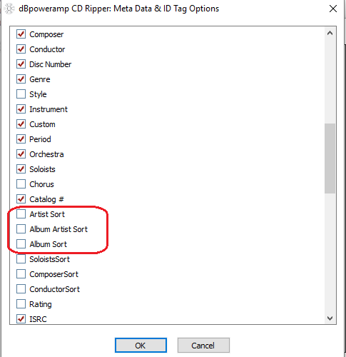

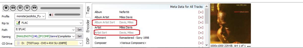

    Oggy, In 'dBpa', on some CDs the: 'Album Artist Sort' and 'Artist Sort' appear in shaded grey. On other CDs these do not appear at all. You did mention this week about how this can help with running a 'search' for an Artist/Album. But I am not sure whether or not they have been configured properly - as our comms got sidetracked in the midst. Thanks, Paul.

            Gary, So should I just leave it as it is? You are probably going to say it's all about "options!" I mean, if I did want to include them then do I just TICK the appropriate boxes in the "Meta Data ID Tag" window (as per screenshot 2 above)? And, assuming they will then automatically appear in the "Meta Data for all Tracks" window (as per screenshot 1 above), what data would you fill in, please? Just the Artists name for both fields?: "Davis, Miles". Thanks.
