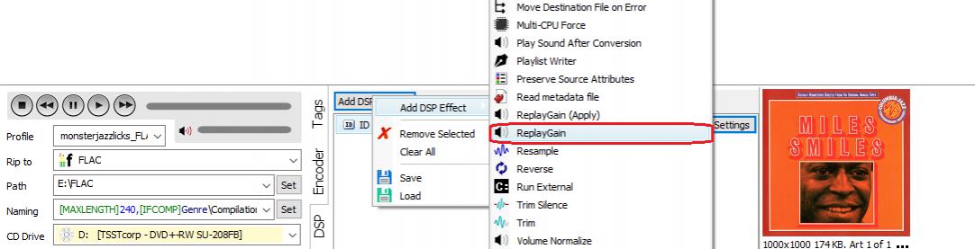

        a. on your dbpa ripper page, in the bottom center, click on the DSP tab. Then "add" a DSP and choose ReplayGain (note, do not choose ReplayGain (Apply)...that's something different).

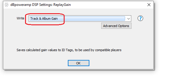

        b. click on the settings next to ReplayGain DSP, and I suggest adding Track and Album tags.

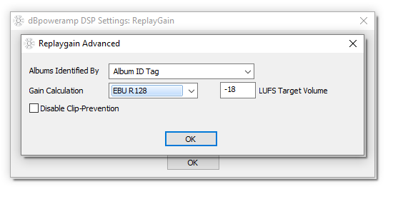

        c. click on advanced and follow my picture. (-18, and don't tick the clipping option)

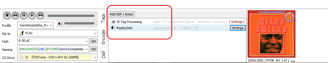

        Gary, Many thanks. I am fairly sure I have followed your kind directions:

        But, do I need to set this each and every time I perform a CD rip in 'dBpa', please? And also, will I now need to re-rip the CDs I have already done earlier this week (ie. without 'RG')?

          Hi Paul,
          No, you just add the DSP, and the ReplayGain tags are written automatically, to each, and every CD you rip.

              for the CDs you've already ripped, you can use dbpa converter, and "convert to" the utility DSP "Replay Gain". This will add RG tags to your already ripped files.

                  yes, looks correct. as noted by others, this will be automatic (it is now part of your ripping profile). by the way, what is the purpose of the ID TAG PROCESSING DSP you seem to be also using.
                                garym,
                                I believe that Paul was using the ID Tag Processing, DSP, to automate, Capitalize First Letter.
