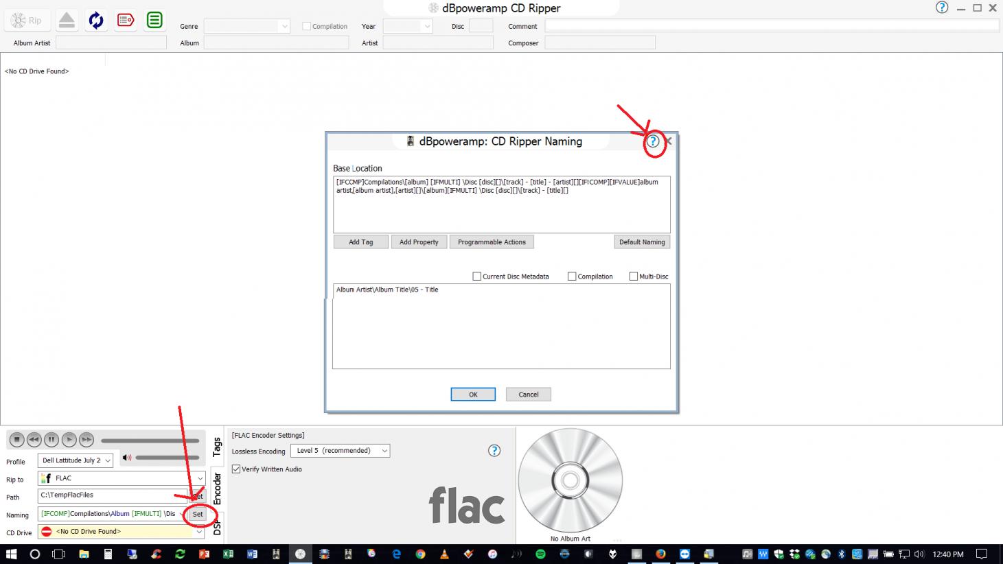

        No. I don't work for dbpoweramp. Just a user like you. Yes there is a logic to the naming strings. it is just some basic code to tell the program to use tag data in a certain way. I've told you how to start....just copy and paste stuff in that I gave you and you're basically done. Have you looked at the help info on naming strings. see attached picture for example. When you click on SET next to naming row, you get the popup where you enter things. If you click on the ? on upper right, it opens the instructions for how this works. There are "?" buttons in almost every page in dbpa. that's where you will find detailed help pages.Click image for larger version
Name:	Screenshot 2017-07-17 12.40.27.jpg
