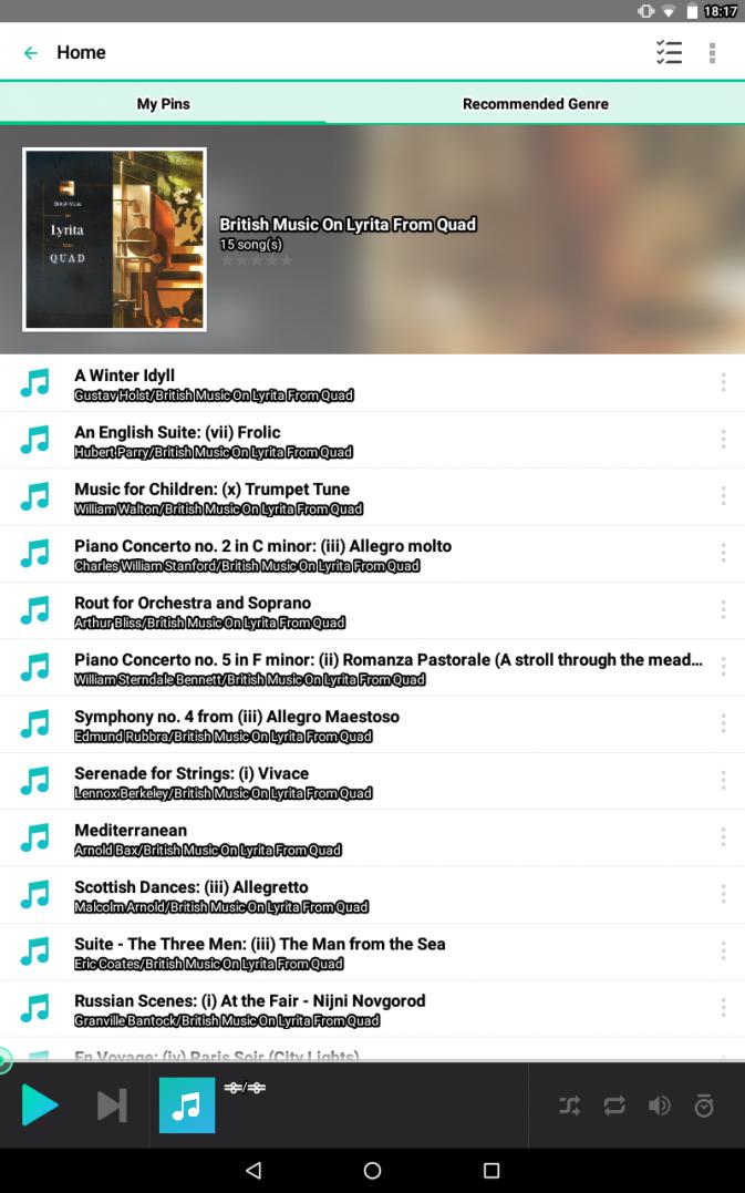

                              This is the British Music on Lyrita by Quad, compilation CD I mentioned, and this is a way to tag it. As I mentioned previously, none of the metadata providers had the Composer name, so this had to be entered manually. My preference is to display the Composer as the Artist, so using View Track-Artist, the 15 different composers, were entered into both Artist and Composer. I also edited Title (track names), using provided metadata, to my preferences, where I also remove the Orchestra and Conductor from the Title.
                              As I see this as a compilation album, I set Compilation to Yes.
                              This took around 10 minutes, and if the Orchestra, Conductor and Soloists are not important, the CD could be ripped at this stage. You mentioned that you have bought a Synology NAS, which I also use. The Synology has a basic player, DS audio, and this is how the British Music on Lyrita by Quad, displays on it:-
                              Once I had this workable, but basic naming, I returned to the front page of CD Ripper, and highlighting one track at a time, hit Tags, and with Add New Tag, added, Orchestra, Conductor, Soloists for the tracks that had a singer, and a custom tag, Pianist for the Piano Concertos.
                              With my limited typing skills, this took around 20 minutes, and meant that each track had tags for Orchestra, Conductor and Soloists / Pianist.
                              This is how those tags show on one track, on the app I use:-
                              You can see the Orchestra, custom Pianist and Replay Gain [I]Tags[/] - I use ReplayGain. The Conductor tag, is on another page.
                              Hopefully this helps with the understanding of adding Tags.
                              There are many ways to skin a cat, and naming and tagging involves many personal choices, particularly with Classical.
                              Players and apps vary massively, so it makes a lot of sense to try things out on your player, before proceeding too far.
                              The great thing with Tags, is you can edit, add or delete them very easily at any time in the future, as your requirements, or indeed player changes.
                              In the above example, you could of course use Various, as the Artist, and have it as a non-compilation, simply with track names, and no tags: the music will play the same.
                              Oggy
