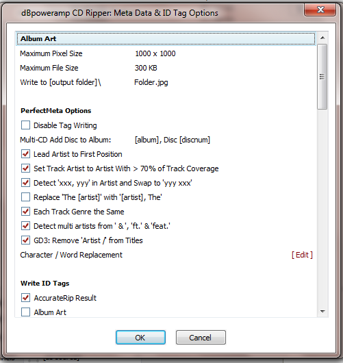

                              #239
                              Re: Set-Up for Ripping
                              Originally posted by dbarnby
                              Re. 5) I don't fully understand, but is the bottom line that I don't have to worry about it. This issue came up in Oggy *163, "If you want Folder.jpg, or Cover.jpg, &*8230; you need to uncheck both Disable Tag Writing AND Album Art, as per screenshot below, and set the appropriate, Write to [output folder]."
                              Don
                              I don't want to rip with the wrong settings. I do want to see cover art; that's my bottom line.
                              Don,
                              None of us want to rip with wrong settings, and advice and warnings are usually given if someone suggests something that it likely to cause a problem.
                              The default CD Ripper settings for Album Art, are 800x800 pixel size, 500x500kb file size, and cover embedded. This will work on both Foobar and Bluesound. The restriction that Bluesound has is a 600kb file size.
                              However, both Foobar and Bluesound will also work with Folder.jpg, and as you have one cover in its own folder, rather than the same cover embedded in each track, it is more efficient and easier to replace the cover in the future.
                              As a number of friends own Sonos, which has a pixel and file size restriction, the 1000x1000 and 300kb was chosen to maintain compatibility,
                              Folder.jpg is probably more commonly used than Cover.jpg, which is the next option down, changing from, None.
                              It is entirely your choice if you want to change from embedded to a Folder.jpg, it is one of those settings that often gets implemented later: Together with a couple of friends, we wish we had used it, and unchecked Write ID Tags to Album Art, from the start.
