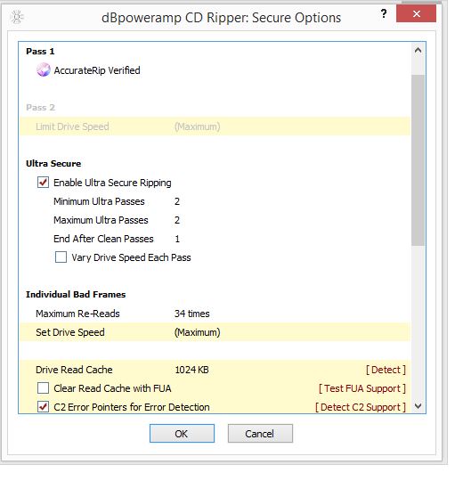

                  Re: burst mode and secure mode results
                  seems odd to me. For me, no matter what, with "ultra secure" ticked, if there is an AR match, it stops and doesn't move on. See attached picture for my settings. Click image for larger version
                        I tried the same settings and got the same weird results as I got previously.
                        Untick C2 and it stops after the first pass with an accurate rip.
                        I still think there's something fishy going on here though and a potential bug with the program. If the checksum is correct after the first pass (which it is) why is going into the ultra secure passes at all?
                        Even if my drive is not reporting C2 errors correctly, why is it ignoring a correct checksum? Sure there could be an anomaly here i.e. checksum correct yet C2 errors reported but it is as if the program is not checking the checksum against the accuraterip database at all if a C2 error is flagged. Given the documentation states C2 error checking isn't infallible even when correctly implemented I find this behaviour very odd.
