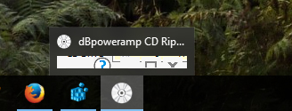

    CD Ripper is the problem: it seems to launch itself but there is no window.

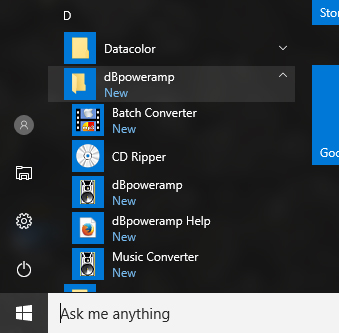

    • I note that in the Start menu the CD Ripper entry is the only one not marked as 'New'.

    Below are a couple of screenshots of what I am seeing on the Start menu and when I hover over the CD Ripper icon.

          Re: CD Ripper not working after paid version installation
          SOLVED
          Somewhere along the line the CD Ripper window co-ordinates or size must have been corrupted. When CD Ripper was launched I was able to hover over the taskbar icon, right-ckick the top of the small window image that appeared and select maximise window. That restored the co-ordinates and size and it now appears to be working normally.
