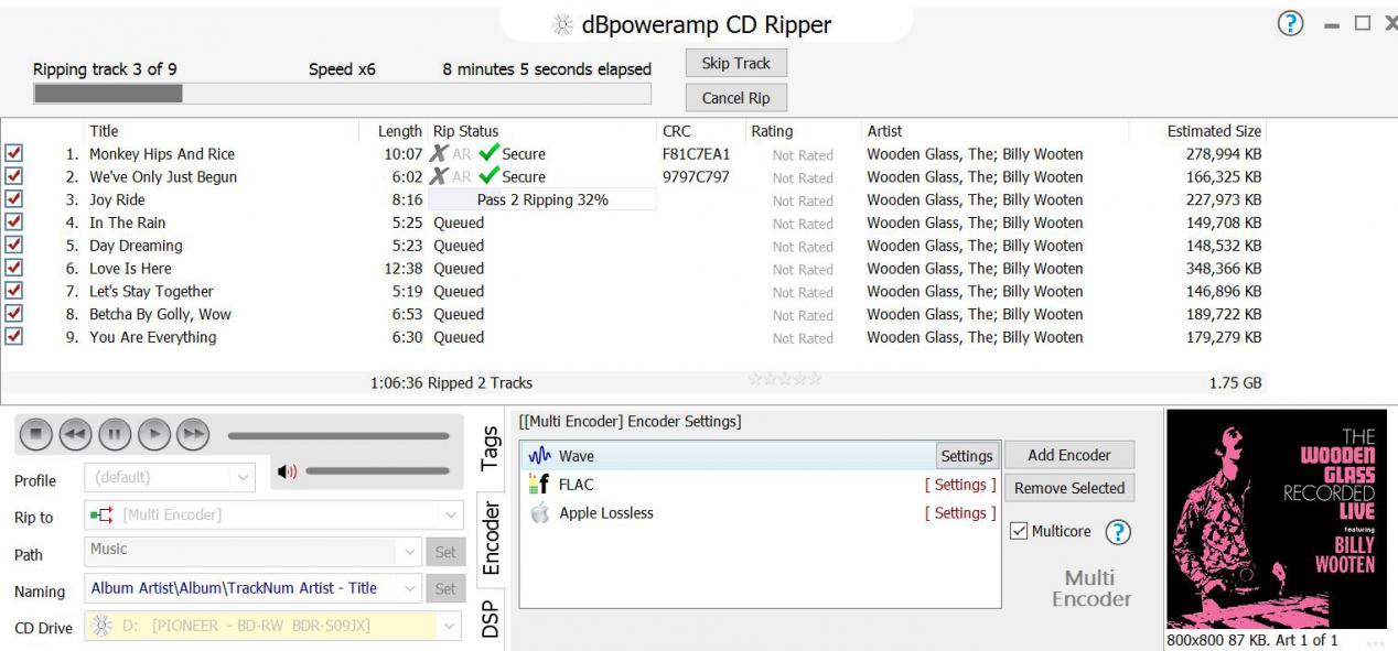

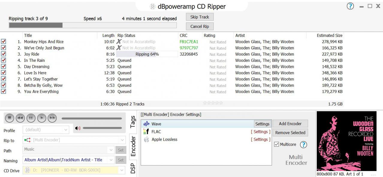

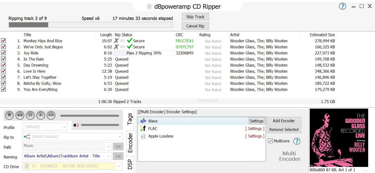

          1. Took some time, but I tested Secure (Ultra Secure OFF) vs Secure (Ultra Secure ON) vs BURST in that order.
Name:	dBpoweramp Secure w Ultra Secure ON.jpg
Name:	dBpoweramp Secure w Ultra Secure OFF.jpg
Name:	dBpoweramp BURST.jpg
          This CD was NOT in AccurateRip DB, but due to multiple passes, SECURE took just over 8min and 17min respectively and BURST reached over the same point in 4min AND matched the same CRC. I also know I can achieve AccurateRip using BURST quite consistently so BURST may become my primary choice on this drive.
          3. FYI, in above test, SECURE option had "Clear Read Cache with FUA" ON and "8KB Transfers" ON.
          4. is also interesting and will try to find out my self as well.

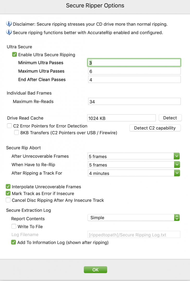

                      What do you have your Secure Ripper Options as? This is mine (I changed the number randomly, wondering what would be the smart way to do it). Click image for larger version
Name:	Screen Shot 2020-07-04 at 12.50.53 AM.jpg

                            I'm not home in front of my computer, but your settings look about the same as what I use. I think I allow more potential time for ripping a track than you do. I used the default on number of frames, time allowed, etc. Of course, these settings don't get used if the ripper finds an AccurateRip match after the first pass.
