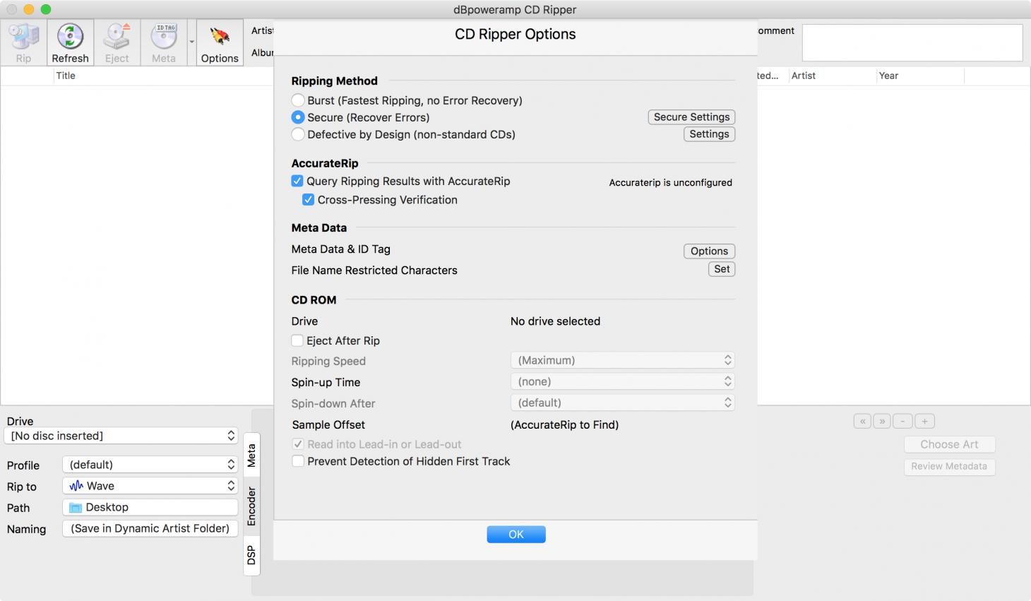

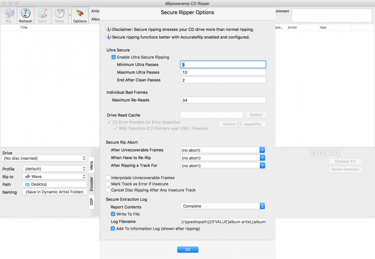

                    These are my settings. Is there anything I can alter to rip "better"?

                      Re: Can someone help me understand the log?
                      [ATTACH=CONFIG]1119[/ATTACH]
                      [ATTACH=CONFIG]1118[/ATTACH]
                      Why have you not configured accuraterip yet? Is this the windows version? If so, you'll need to feed it some common CDs until it configures. Could work with one or might need 3 or 4 until it configures.
                        This is on a iMac. I don't have any common CDs. I only have a handful of CDs and none of them are retail discs.
                          I thought the Mac version automatically setup AccurateRip. But not sure. Someone with the Mac version will have to address this question.
                              On the mac it does not matter if accuraterip has the offset or not, all discs are checked against accuraterip using pressing offset finding.
