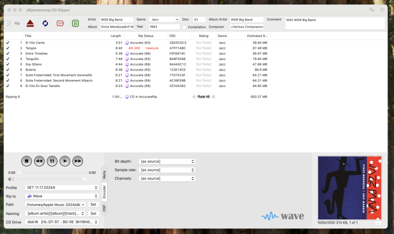

    I've been using CD Ripper for over a year now. Now and then I experience a track that is "unsecure," generally with a used CD. I buy (and already own) a lot of used CDs, and this happens maybe 1 out of 30 or 40 CDs, and I assume that is just part of life ripping CDs. But a few weeks ago, when this happened, I really wanted a secure rip of all tracks so I bought copy #2 of the CD (used). The same track was unsecure on CD @2, so I bought a new CD (copy #3), and the same track is unsecure on that CD, too. The track plays OK on my CD player, but I think I'm hearing a few transients on the track in question that sound slightly distorted, and I don't hear that distortion on the other tracks. Maybe this points to a manufacturing defect that affected all 3 CDs, but I thought I'd post to see what others think?

          What was the confidence number for the other tracks?

            Looks like 40 - see screen shot attached.
