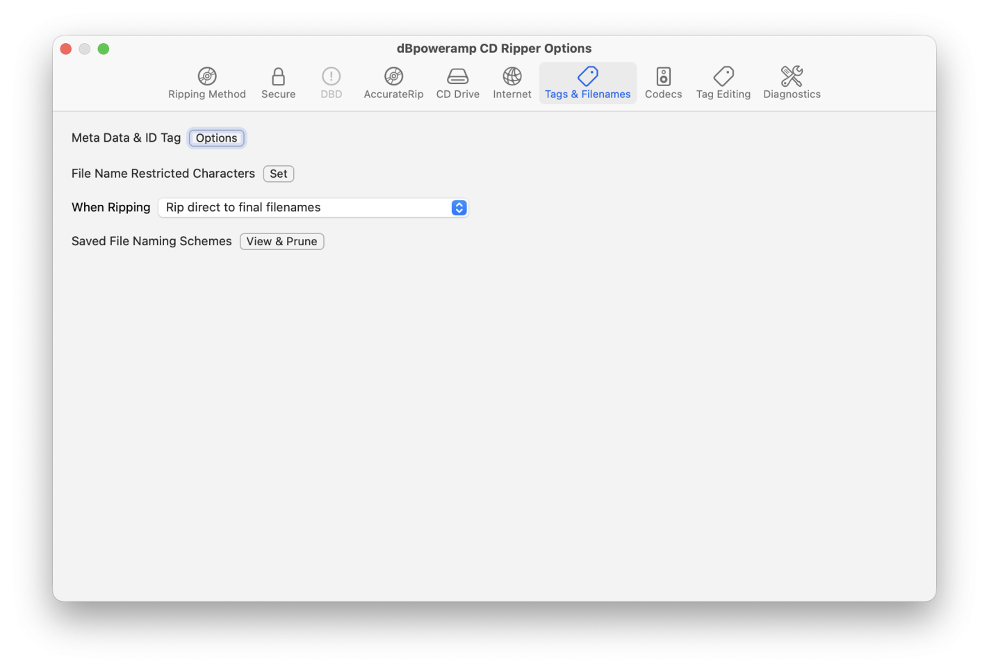

    I'm trying to rip CDs on CD Ripper v.2025-12-24 (1) on a Mac-mini running OS 26.1. I'm still on the 21 day test period (I think). After scanning several CDs quite seamlessly the other day, the ripped files suddenly started saving as TMP files and not FLAC, as selected. I noticed one other person with the same issue on Windows and the advice was to delete CD Ripper, restart the computer, reinstall, and that should fix it. It didn't in my case. If that didn't work, the next advice was to go to " CD Ripper >> ripper options button (I can't find this button)>> when ripping 'Rip direct to final filenames'" (I can't find this option) . Can anyone help me understand these instructions or let me know why I'm getting TMP files instead of FLAC and how to fix it?

    It is there, 'When ripping' see the first picture.

      Thanks very much for the quick response. I found it, tho it's in a different window on a Mac. All is working again.

        By design, the files are written to .tmp and renamed to correct extension when encoding has finished. This is to keep other applications from trying to index them while dBpoweramp is still working.
        Did you just see .tmp files while ripping was still in progress, or were they left as .tmp when ripping has completed?
        Were there any error messages shown in dBpoweramp?
