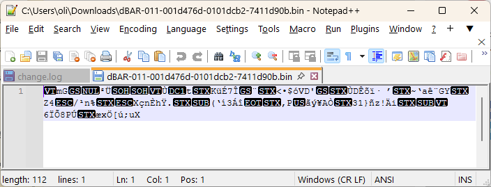

    Try reading that file using a browser, that is a bin file for a disc, your browser should download a bin file.
    I'm not sure what I'm doing here. I downloaded the file but I can't get it to open in Edge or Firefox. In Notepad++ I see:
      Then the lookup is working, perhaps your firewall is blocking the accuraterip component.

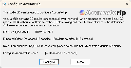

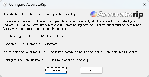

        I was wondering about that. Does the fact that I see this screen mean I have access to the Accuraterip server?:
        I've had about 3 CDs for which this does not appear. I see it for all the rest (80+ now).

                So, for whatever reason, my ASUS TUF Gaming B650-PLUS (with latest drivers) prevents Accuraterip working on its SATA ports. In my post #6 here, I recorded that Windows Device Manager reported one of my drives as "PLDS DVD-RW DH16AESH". It shows exactly the same name through the PCI-E card, so that isn't the cause of the problem. I wonder what it is.
