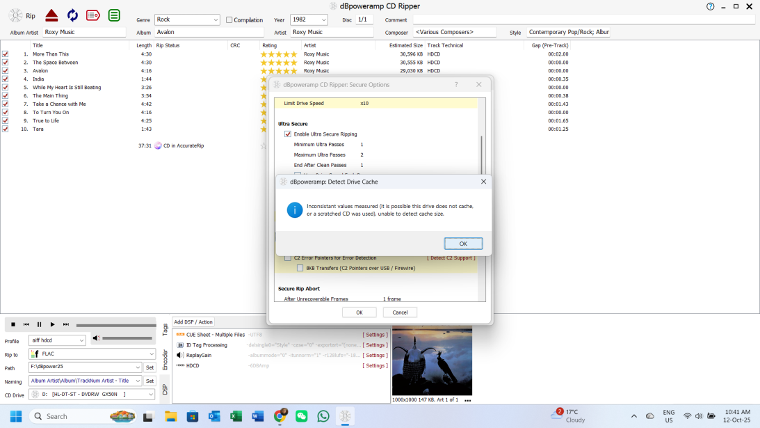

    i just did an clean install of the Windows 25h2 on my acer nitro5 ( 2 x m.2 7450 mbps / 64bg RAM )
    on starting the version already with me, i was asked to update to dBpower 2025-7-21 (64bit), which i did.
    the drive i use is the Apple Super Drive, which shows up as the LG HL-DT-ST - DVDRW - GX50 (please see botton left of he screenshot ) i have used this drive to rip many .. many CDs and have achieved some super rips
    on inserting a CD to configure the drive, i get the attached message when configuring the drive cache.
    the Cd : Roxy Music "Avalon" is in immaculate condition.
    please could any one assist as to why is this happening

      so i uninstalled dBpower (with RevoUninstaller)
      cleaned regedit for illustrate / spoon / dBpower & re installed 2024-11-04
      works

        Inconsistent offsets means just that, the offset of the drive is changing between tracks, it should not do this.
        The next step would be to get a different CD drive.

          good day to you Sir,
          after the clean uninstall & re install of 2024-11-04, the same drive testeded, in like almost immediately ( as it normally does ) & so did the 2nd menu, mentioning the drive cache is to be set to "0" ( (zero) but i keep it to 1024, recomended by one of your manuals )
          every thinhg seemd to be working as it should be .
          i'm not sure if i will update to the 2025-7-21, immediately but will kee you in the loop
