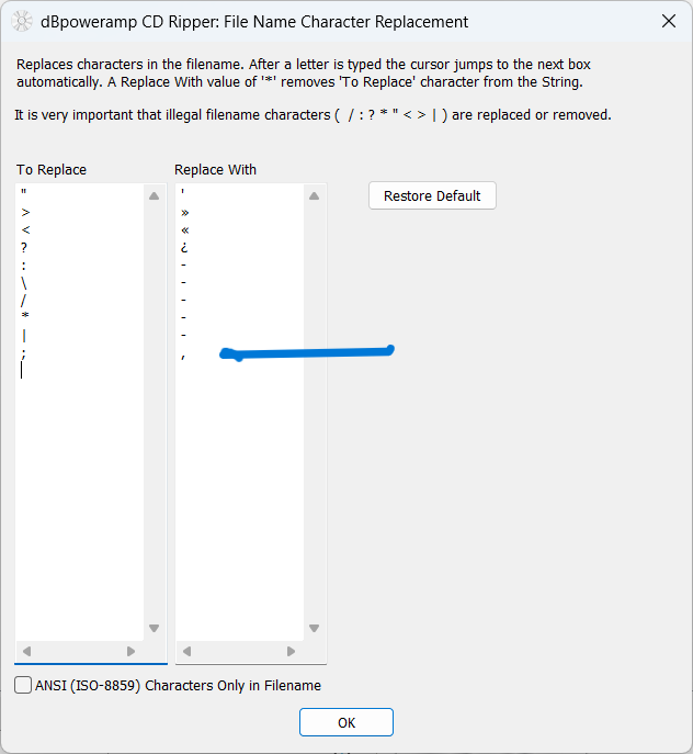

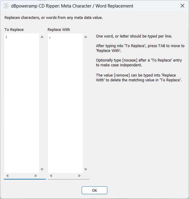

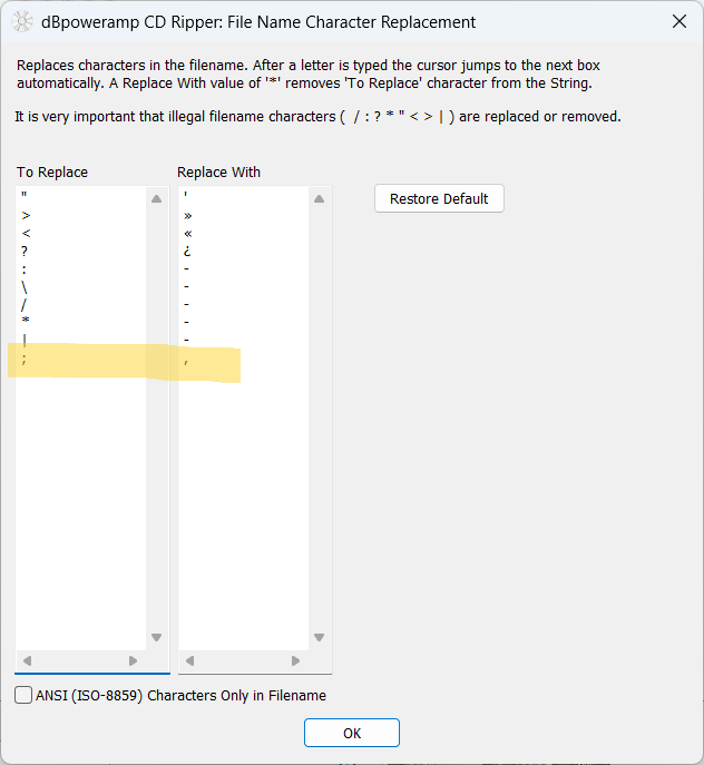

    hi everyone !!
    trust all are well
    i have some CDs where there are multiple artists, seperated by a ";" i have made the addition for it to replace by "'," in the "tags & filenames" section. unfortunately, the change does not take place & only the 1st artist name is shown after the rip.
    any Assistance is welcome

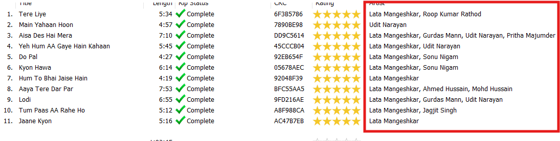

      hi Sir,
      i did that after making the changes but no luck, so i do it manually.
      this hapens in the "artist name" while ripping the CDs
      the attached screen shot, is what i did manually

          • 1914
          It's not a question of character replacement, but editing the metadata before or after ripping. I.e. Check the artist tag before ripping and use ";" (semicolon plus space) to delimit each artist from the next one.
              The semi-colon is used in all illustrate products (dBpoweramp, PerfectTUNES etc) to let the user know that a tag contains multiple values; it's not stored in the file itself.
              Given the semi-colon isn't a literal character there's nothing to replace. If you perform a rip without modifying the Artist tag (so it contains semi-colons) in what screen/app is only the 1st artist name shown?
