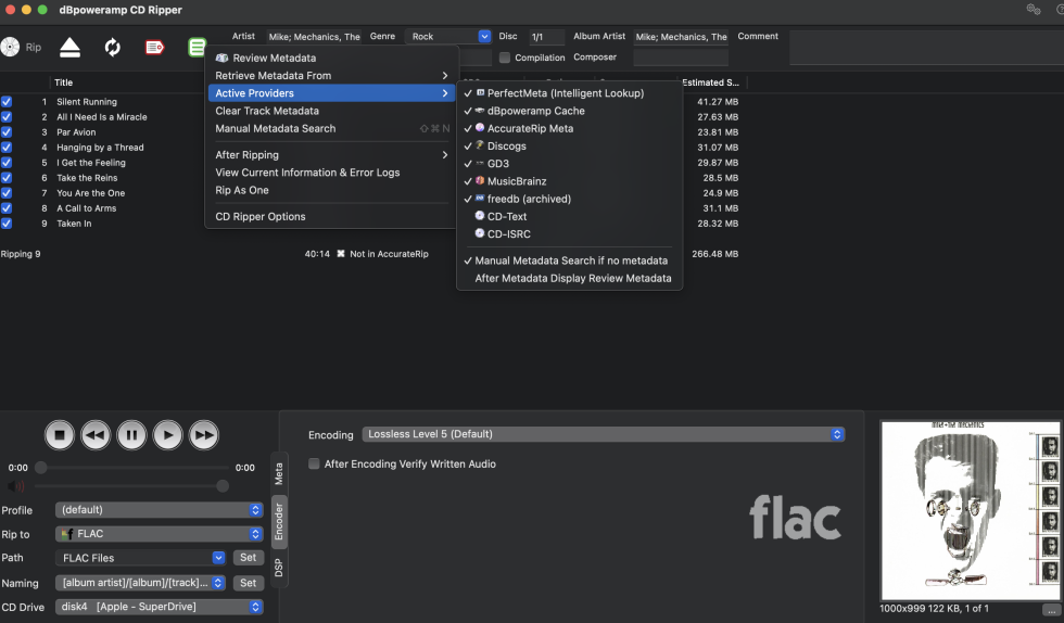

    • Hi everyone, hope all is well. I had some problems with my Macbook and could not use a Time Machine back up to reinstall, or according to Apple support I would be reinstalling the same problem. Bottom line is that I had to save all my FLAC files and a few documents to another external hard drive and reset the Mac to like brand new, a new user set up "Hello" on the screen. It was a MAJOR mission, but I did manage to get it done. I also managed to reinstall dBpoweramp, however it seems that there may have been some changes since my original installation. Please, can someone help with the following: 1) I used to be able to get an on-screen rip result without having to save the log in a text file to the album file. This was handy for a variety of reasons but also saved a tiny bit of space, and my HD is almost full. Now, with the reinstall that option seems either to be gone, or not working. I have checked the box "Add information to log after ripping" but I get no rip result log. What am I missing heree? 2) I got some new discs today, so far out of 2 they both retrieve the Metadata like album art, Track names, artist, album etc but none are in accurate rip and I have Accurate Rip enabled with Ultra secure as well?? They are international artists, and I would think very popular, so it is hard for me to understand why they would not be in Accurate rip? Any ideas on this for me? 3) The set up layout seems to have changed? Can someone confirm this? Most of it is there and I can configure it pretty much as before, but I used to click on the green ripping set up icon and it was all there, now I get a window with option buttons at the top, "Ripping method" , "Secure", "DBD" (unavailable to click on), "Accurate Rip", "Tags and File Names" and "CD Drive". Is this an update? It seems a little more confusing than before. Thank you and looking forward to some help figuring this all out again. Regards to all! Sorry Spoon, I sent this as a message by mistake, I meant to post it here. Apologies!
      • Click image for larger version  Name:	Screenshot 2024-12-07 at 16.44.40.png Views:	0 Size:	173.6 KB ID:	329271
    • 46220

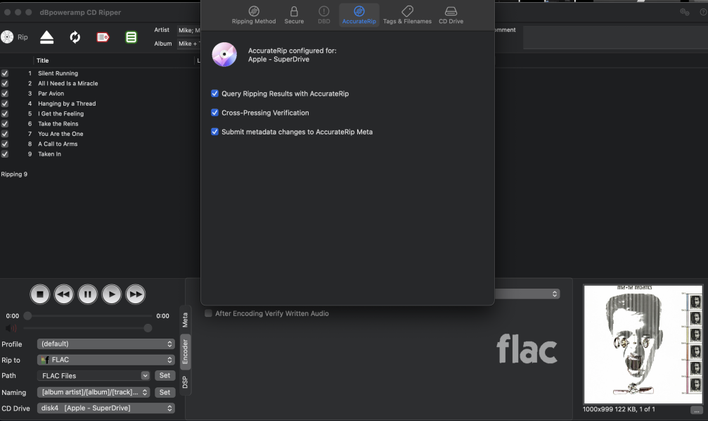

          Hi Again, please see attached. Accurate Rip is checked as an "active provider" but every album I insert the program says not in accurate rip with a white cross Click image for larger version
Name:	Screenshot 2024-12-07 at 20.50.15.png
            • 46220
            AccurateRip Meta is the metadata database not the AccurateRip database, that option would be on the main options page.

              I think Accurate Rip IS enabled, please advise if I am in the wrong setting section?
                • 46220
                Yes that is enabled, see if you can browse AccurateRip.com

                            I have reinstalled dB from my original email link, and selected the Mac Sequoia version. Accurate Rip says it is configured for my USB Superdrive, but I am still getting exactly the same result, disc not in accuraterip with the white cross. I have looked at every setting I can think of, restarted the laptop, reinstalled, it says configured for my drive, it is checked as a Metadata source, but none of my discs are being recognised as in Accuratrip. So Now, because it is not in Accuraterip, it is reading each track 4 times, 2 passes, and 2 Ultra secure.
