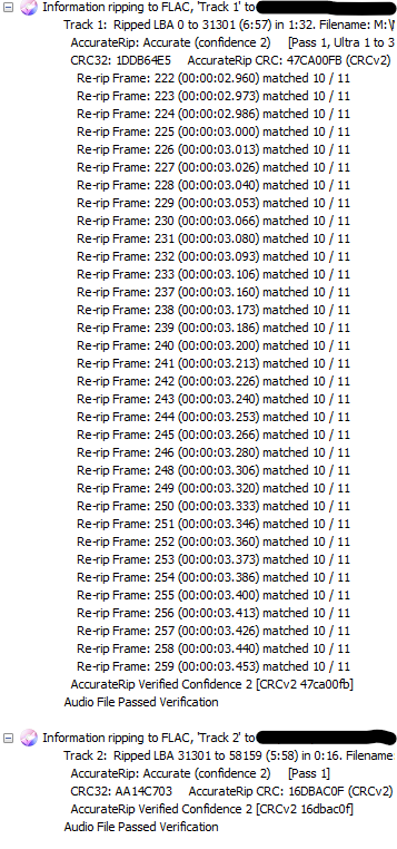

    My problem is that it seems that on each CD, only the first track is ripped with Ultra Secure and then all the other tracks are getting ripped without Ultra Secure. Almost as if Ultra Secure Ripping stopped after the first track on every CD.
    Here it works on the first track: Click image for larger version
Name:	Ultra Secure.png
    After that, we move on to track 2 and Ultra Secure is not applied.

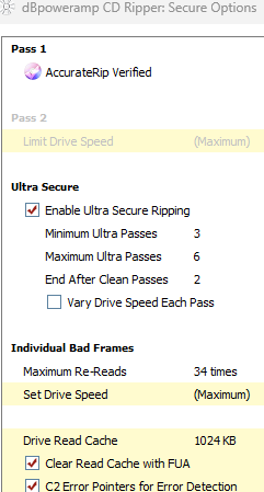

    My Secure Options:
Name:	Secure Options.png
    In the end, only the first track will have Re-rip Frames. If you disable Ultra Secure Ripping, the Re-Rip Frames will not be listed here in the results:
Name:	Re-rip Frame.png

    1 + 2 are both related, the drive is giving out bad data. Perhaps try the spin up option set to maximum.
      and if you get an accurate rip match initially it never has to go through the extra ultra secure passes. That is the beauty of accuraterip.

        Thank you, the solution to questions 1+2 has been found and fixed with "Spin-up Time 4 seconds". No more Re-rip Frames and a direct match with AccurateRip. But this also means no Ultra Secure Ripping at all.
