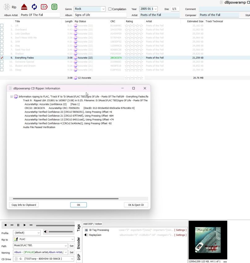

    Hello, I think I just came across a bug or I do not fully understanding how this is supposed to work :-) I am using the latest version of dBpoweramp Reference (2024-05-30). It is my understanding that if I have HDCD checked under CD Ripper->Preferences->Meta Data & ID Tag options, dBpoweramp should write that tag if it detects a track as HDCD regardless of if I have HDCD set as a DSP option or not. I do not believe that is happening.

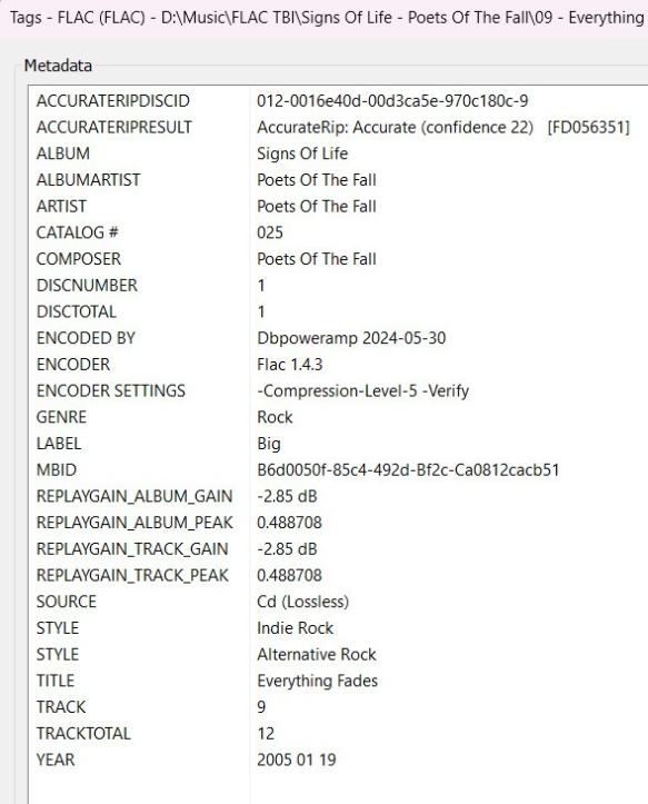

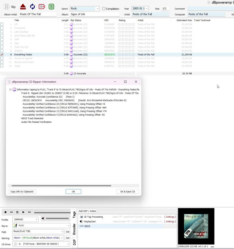

    I added 2 screenshots. The first one shows that dBpoweramp detected a track as HDCD during ripping, but when I look at the tags with Mp3tag. I do not see a HDCD tag. I added the HDCD DSP effect for this test.
    The second screenshot shows that dBpoweramp did not detect the same track as HDCD after I removed the HDCD DSP effect. I also do not see a HDCD tag.
    Am I missing something or is this a bug? Shouldn’t the tag have been written? I can provide more screenshots or logs if necessary. Any help would be appreciated :-)
