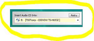

    Hi
    I'm using the product for many months now.
    No problem with until today. When I launch the service, it seems it's running but nothing appears on the screen except "insert Audio CD into" Menu (see attachment). The main menu dpesn't appear on the screen but it seems the service is running.
    I already did an uninstall/install. But the problem is still there.
    I'm on a Vista SP2 computer (32 bits).
    Does anybody knows this problem? can provide help.
    Best regards.

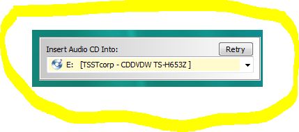

    Re: CD Ripper
    Hi! Glad you posted this, as I have the exact same issue.
    Tried same thing: un-install and re-install, but to no avail.
    I'm running Vista Home premium SP2 64-Bit
    Anyone else?

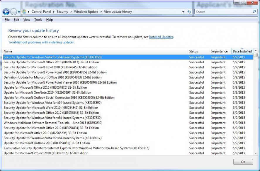

                • jpf
                  • Jun 2015
                  Re: CD Ripper
                  No, Avira. My Vista is Home Premium SP2 64-Bit. It seems like I lost dbpoweramp functionality after the Vista security updates on Tuesday.

                  • Art_Vandelay
                    • Jun 2015
                    • 14
                    Re: CD Ripper
                    Seems the common denominator is the Vista Updates.

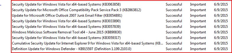

                    • Art_Vandelay
                      • Jun 2015
                      • 14
                      Re: CD Ripper
                      Ive also re-verified , and there are no more Windows Updates available.
