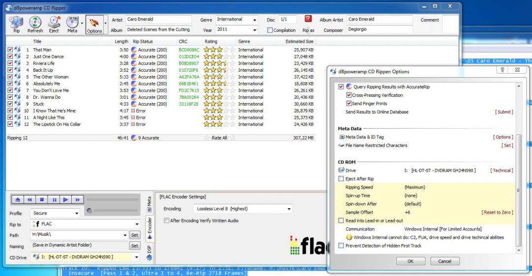

                    A rip with dBpoweramp and ripping method "burst" also results in audibly distorted files.

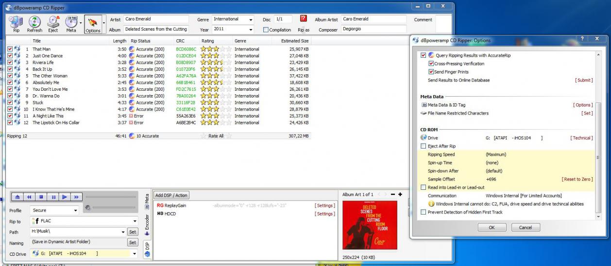

                        Re: Bug? Exact Audio Copy works where dbpoweramp doesn't?
                        Sorry for the delay, I was on holiday for ten days
                        The ripping result after switching to communication method "windows internal" (and restarting the program) seems to be the same:
                        Error ripping to FLAC, 'Track 11' to 'H:\Musik\Caro Emerald\Deleted Scenes from the Cutting Room Floor\11 Caro Emerald - A Night Like This.flac'
                        Unable to read CD, check CD disc (frame LBA 191585 ripping 26 frames track end LBA 193787) [clRipperSecure::Rip]
                        Error ripping to FLAC, 'Track 12' to 'H:\Musik\Caro Emerald\Deleted Scenes from the Cutting Room Floor\12 Caro Emerald - The Lipstick On His Collar.flac'
                        Unable to read CD, check CD disc (frame LBA 193788 ripping 26 frames track end LBA 210100) [clRipperSecure::Rip]

                        dBpoweramp Release 15 Digital Audio Extraction Log from Dienstag, 15. Juli 2014 12:00
                        Drive & Settings
                        Ripping with drive 'G: [ATAPI - iHOS104 ]', Drive offset: 696, Overread Lead-in/out: No
                        Ultra:: Vary Drive Speed: No, Min Passes: 2, Max Passes: 4, Finish After Clean Passes: 2
                        Encoder: FLAC -compression-level-8
                        DSP Effects / Actions: -dspeffect1="ReplayGain=-albummode={qt}0{qt} -r128 -r128lufs={qt}-23{qt}" -dspeffect2="HDCD="

                        Track 11: ERROR Ripping LBA 176842 to 193787 (3:45) in 0:32. Filename: H:\Musik\Caro Emerald\Deleted Scenes from the Cutting Room Floor\11 Caro Emerald - A Night Like This.flac
                        Track 12: ERROR Ripping LBA 193787 to 210100 (3:37) in 0:36. Filename: H:\Musik\Caro Emerald\Deleted Scenes from the Cutting Room Floor\12 Caro Emerald - The Lipstick On His Collar.flac
                        12 Tracks Ripped: 10 Accurate, 2 Could Not Be Ripped

                            AccurateRip Verified Confidence 111 [CRCv1 db638f3a]
                            AccurateRip Verified Confidence 200 [CRCv2 b8004665], Using Pressing Offset +12
                            AccurateRip Verified Confidence 76 [CRCv1 936a1f2], Using Pressing Offset +12
                            Information ripping to FLAC, 'Track 6' to 'H:\Musik\Caro Emerald\Deleted Scenes from the Cutting Room Floor\06 Caro Emerald - Absolutely Me.flac'
                            Track 6: Ripped LBA 93466 to 105893 (2:45) in 0:06. Filename: H:\Musik\Caro Emerald\Deleted Scenes from the Cutting Room Floor\06 Caro Emerald - Absolutely Me.flac
                            AccurateRip: Accurate (confidence 200) [Pass 1]
                            CRC32: 66B1B461 AccurateRip CRC: 30E73B91 (CRCv2) [DiscID: 012-0014e8c4-00c320af-9f0af10c-6]
                            AccurateRip Verified Confidence 200 [CRCv2 30e73b91]
                            AccurateRip Verified Confidence 111 [CRCv1 5872ec01]
                            AccurateRip Verified Confidence 200 [CRCv2 c0db4092], Using Pressing Offset +12
                            AccurateRip Verified Confidence 76 [CRCv1 e9a3c443], Using Pressing Offset +12
                            Information ripping to FLAC, 'Track 7' to 'H:\Musik\Caro Emerald\Deleted Scenes from the Cutting Room Floor\07 Caro Emerald - You Don't Love Me.flac'
                            Track 7: Ripped LBA 105893 to 123431 (3:53) in 0:09. Filename: H:\Musik\Caro Emerald\Deleted Scenes from the Cutting Room Floor\07 Caro Emerald - You Don't Love Me.flac
                            CRC32: FD2C7615 AccurateRip CRC: BCBB31E7 (CRCv2) [DiscID: 012-0014e8c4-00c320af-9f0af10c-7]
                            AccurateRip Verified Confidence 200 [CRCv2 bcbb31e7]
                            AccurateRip Verified Confidence 111 [CRCv1 588283ed]
                            AccurateRip Verified Confidence 200 [CRCv2 20de1d25], Using Pressing Offset +12
                            AccurateRip Verified Confidence 76 [CRCv1 c04f6ddb], Using Pressing Offset +12
                            Information ripping to FLAC, 'Track 8' to 'H:\Musik\Caro Emerald\Deleted Scenes from the Cutting Room Floor\08 Caro Emerald - Dr. Wanna Do.flac'
                            Track 8: Ripped LBA 123431 to 137079 (3:01) in 0:06. Filename: H:\Musik\Caro Emerald\Deleted Scenes from the Cutting Room Floor\08 Caro Emerald - Dr. Wanna Do.flac
                            CRC32: 78A00264 AccurateRip CRC: E01A444F (CRCv2) [DiscID: 012-0014e8c4-00c320af-9f0af10c-8]
                            AccurateRip Verified Confidence 200 [CRCv2 e01a444f]
                            AccurateRip Verified Confidence 111 [CRCv1 6eb1ca21]
                            AccurateRip Verified Confidence 200 [CRCv2 dc447fcf], Using Pressing Offset +12
                            AccurateRip Verified Confidence 75 [CRCv1 6db12589], Using Pressing Offset +12
                            Information ripping to FLAC, 'Track 9' to 'H:\Musik\Caro Emerald\Deleted Scenes from the Cutting Room Floor\09 Caro Emerald - Stuck.flac'
                            Track 9: Ripped LBA 137079 to 157555 (4:33) in 0:09. Filename: H:\Musik\Caro Emerald\Deleted Scenes from the Cutting Room Floor\09 Caro Emerald - Stuck.flac
                            CRC32: 33116F28 AccurateRip CRC: 2186D771 (CRCv2) [DiscID: 012-0014e8c4-00c320af-9f0af10c-9]
                            AccurateRip Verified Confidence 200 [CRCv2 2186d771]
                            AccurateRip Verified Confidence 112 [CRCv1 d9c15024]
                            AccurateRip Verified Confidence 200 [CRCv2 e8fafeab], Using Pressing Offset +12
                            AccurateRip Verified Confidence 76 [CRCv1 a5664e80], Using Pressing Offset +12
                            Information ripping to FLAC, 'Track 10' to 'H:\Musik\Caro Emerald\Deleted Scenes from the Cutting Room Floor\10 Caro Emerald - I Know That He's Mine.flac'
                            ** Aborted: Have to ReRip 2718 Frames, Re-Rip Limit Set to 100 Frames
                            Track 10: Ripped LBA 157555 to 176842 (4:17) in 1:51. Filename: H:\Musik\Caro Emerald\Deleted Scenes from the Cutting Room Floor\10 Caro Emerald - I Know That He's Mine.flac
                            Insecure [Pass 1 & 2, Ultra 1 to 4, Re-Rip 2718 Frames]
                            Information ripping to FLAC, 'Track 11' to 'H:\Musik\Caro Emerald\Deleted Scenes from the Cutting Room Floor\11 Caro Emerald - A Night Like This.flac'
                            ** Aborted: Have to ReRip 5246 Frames, Re-Rip Limit Set to 100 Frames
                            Track 11: Ripped LBA 176842 to 193787 (3:45) in 2:24. Filename: H:\Musik\Caro Emerald\Deleted Scenes from the Cutting Room Floor\11 Caro Emerald - A Night Like This.flac
                            Insecure [Pass 1 & 2, Ultra 1 to 4, Re-Rip 5246 Frames]
                            Information ripping to FLAC, 'Track 12' to 'H:\Musik\Caro Emerald\Deleted Scenes from the Cutting Room Floor\12 Caro Emerald - The Lipstick On His Collar.flac'
                            ** Aborted: Have to ReRip 2833 Frames, Re-Rip Limit Set to 100 Frames
                            Track 12: Ripped LBA 193787 to 210100 (3:37) in 3:28. Filename: H:\Musik\Caro Emerald\Deleted Scenes from the Cutting Room Floor\12 Caro Emerald - The Lipstick On His Collar.flac
                            Insecure [Pass 1 & 2, Ultra 1 to 4, Re-Rip 2833 Frames]
                            dBpoweramp Release 15 Digital Audio Extraction Log from Mittwoch, 16. Juli 2014 12:25
                            Drive & Settings
                            Ripping with drive 'I: [HL-DT-ST - DVDRAM GH24NS90 ]', Drive offset: 6, Overread Lead-in/out: No
                            Extraction Log
                            Track 1: Ripped LBA 0 to 17302 (3:50) in 0:21. Filename: H:\Musik\Caro Emerald\Deleted Scenes from the Cutting Room Floor\01 Caro Emerald - That Man.flac
                            CRC32: BCD6086C AccurateRip CRC: 7E12D06C (CRCv2) [DiscID: 012-0014e8c4-00c320af-9f0af10c-1]
                            AccurateRip Verified Confidence 200 [CRCv2 7e12d06c]
                            AccurateRip Verified Confidence 112 [CRCv1 2ea12c3c]
                            AccurateRip Verified Confidence 200 [CRCv2 460b549d], Using Pressing Offset +12
                            AccurateRip Verified Confidence 75 [CRCv1 fa26cbdc], Using Pressing Offset +12
                            Track 2: Ripped LBA 17302 to 35366 (4:00) in 0:13. Filename: H:\Musik\Caro Emerald\Deleted Scenes from the Cutting Room Floor\02 Caro Emerald - Just One Dance.flac
                            CRC32: 012DCE04 AccurateRip CRC: FEC0BE88 (CRCv2) [DiscID: 012-0014e8c4-00c320af-9f0af10c-2]
                            AccurateRip Verified Confidence 200 [CRCv2 fec0be88]
                            AccurateRip Verified Confidence 110 [CRCv1 4d0bfe27]
                            AccurateRip Verified Confidence 200 [CRCv2 eabe9661], Using Pressing Offset +12
                            AccurateRip Verified Confidence 76 [CRCv1 3cbc2557], Using Pressing Offset +12
                            Track 3: Ripped LBA 35366 to 51013 (3:28) in 0:10. Filename: H:\Musik\Caro Emerald\Deleted Scenes from the Cutting Room Floor\03 Caro Emerald - Riviera Life.flac
                            CRC32: B08D8907 AccurateRip CRC: 69810DD1 (CRCv2) [DiscID: 012-0014e8c4-00c320af-9f0af10c-3]
                            AccurateRip Verified Confidence 200 [CRCv2 69810dd1]
                            AccurateRip Verified Confidence 112 [CRCv1 4c5ac2a9]
                            AccurateRip Verified Confidence 200 [CRCv2 d468ef01], Using Pressing Offset +12
                            AccurateRip Verified Confidence 76 [CRCv1 ba901a05], Using Pressing Offset +12
                            Track 4: Ripped LBA 51013 to 68474 (3:52) in 0:10. Filename: H:\Musik\Caro Emerald\Deleted Scenes from the Cutting Room Floor\04 Caro Emerald - Back It Up.flac
                            CRC32: 010720F6 AccurateRip CRC: 3CFD5D7D (CRCv2) [DiscID: 012-0014e8c4-00c320af-9f0af10c-4]
                            AccurateRip Verified Confidence 200 [CRCv2 3cfd5d7d]
                            AccurateRip Verified Confidence 113 [CRCv1 efe955df]
                            AccurateRip Verified Confidence 200 [CRCv2 f05152bf], Using Pressing Offset +12
                            AccurateRip Verified Confidence 76 [CRCv1 a6f3afd3], Using Pressing Offset +12
                            Track 5: Ripped LBA 68474 to 93466 (5:33) in 0:14. Filename: H:\Musik\Caro Emerald\Deleted Scenes from the Cutting Room Floor\05 Caro Emerald - The Other Woman.flac
                            CRC32: A62FA76A AccurateRip CRC: 8F67B2B8 (CRCv2) [DiscID: 012-0014e8c4-00c320af-9f0af10c-5]
                            AccurateRip Verified Confidence 200 [CRCv2 8f67b2b8]
                            12 Tracks Ripped: 9 Accurate, 3 Inaccurate
