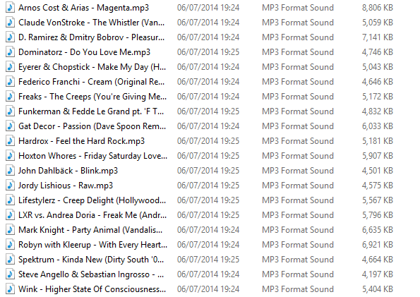

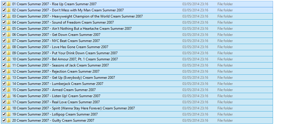

                        I have noticed a difference in the naming of the two cds i am working with.
                        This is the first one that works looks like this
                        and the second looks like this

                          Originally posted by Dogstar
                          Yeah they are already set to various artists.
                          [ATTACH=CONFIG]282[/ATTACH]
                          [ATTACH=CONFIG]283[/ATTACH]
                          Your images are showing file names.....just to re-emphasize a point made earlier in the conversation, file naming is NOT determinate here. There is metadata ("tags") embedded within each audio file, no matter how that file happens to be named. It is that embedded data that is used by playback devices.
                          It sounds like you've dealt with the metadata part of your compilations problem. If setting a common ALBUM ARTIST, as well as setting the COMPILATION flag, do not resolve the issue in your car player, the issue lies with your car player. I'd suggest you first look through its documentation and see if there are any setting options for how to deal with compilations. Most home players have this, but I'm not too optimistic about your car. (In my experience, car players, no matter how fancy or pricey, tend to be pretty crude playback devices.) While it may not have a setting to force the approach you'd prefer, it should at least have a default approach that it always uses.
                          If your car player completely lacks the ability to recognize compilations through the "traditional" methods of flag or common ALBUM ARTIST, which would be kinda bizarre, you'd have no choice to tag (again....not about changing the file name) the files with only a common ARTIST name.

                            I understand the embedded data a device looks at. The only reason i posted those two images was that when we initially spoke on this thread, i used the manipulation as you suggested, and the first image was the one that actually works in the car. What confuses me is when i use the batch converter with what i believe to be the exact same settings, even i with the same disk, the file does not catologue the mp3 correctly in te car nor does it assign the same file naming convention as the one shown in the first image but as shown in the second image. I am wondering if there is something i am not setting correctly or that the manipulation is not executing. How do i know if the manipulation has executed?
