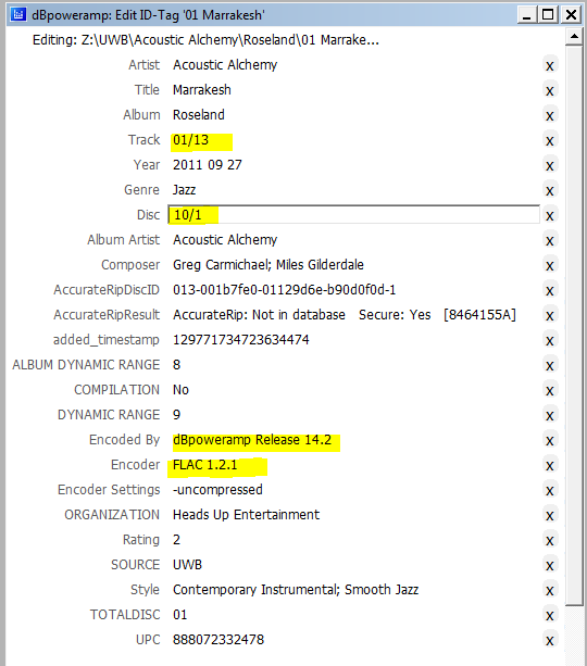

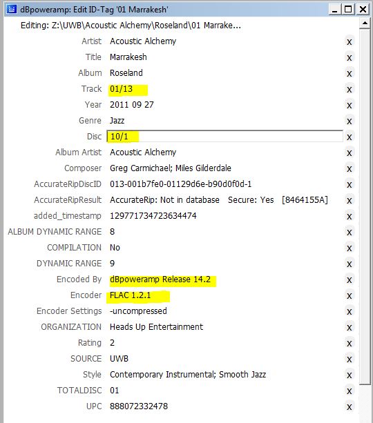

        I just figured out, that some of my older flac files still contain the pattern xx/yy, for "track" and for "disc" so, the conversion worked correct.
        Question 1:
        May I change the pattern for track and disc (from xx/yy to xx; where xx is current track or disc and yy is total tracks or discs) in the meda data,
        when I convert the file from flac to wav with the batch converter?
        Question 2:
        I realized, that some "dbpoweramp fields" are not updated during the batch converter process e.g. "Encoded by", which should change from 14.2 to 17.2
        and "Encoder" which should changed from flac to wav
ID:	294420Click image for larger version

          May I change the pattern for track and disc (from xx/yy to xx; where xx is current track or disc and yy is total tracks or discs) in the meda data, when I convert the file from flac to wav with the batch converter?
          In your flacs, populate the TRACKTOTAL and DISCTOTAL tags.
          Launch:
          dBpoweramp Control Center > Configuration > Advanced Settings and tick the Update 'Source', 'Encoder' etc. option.
