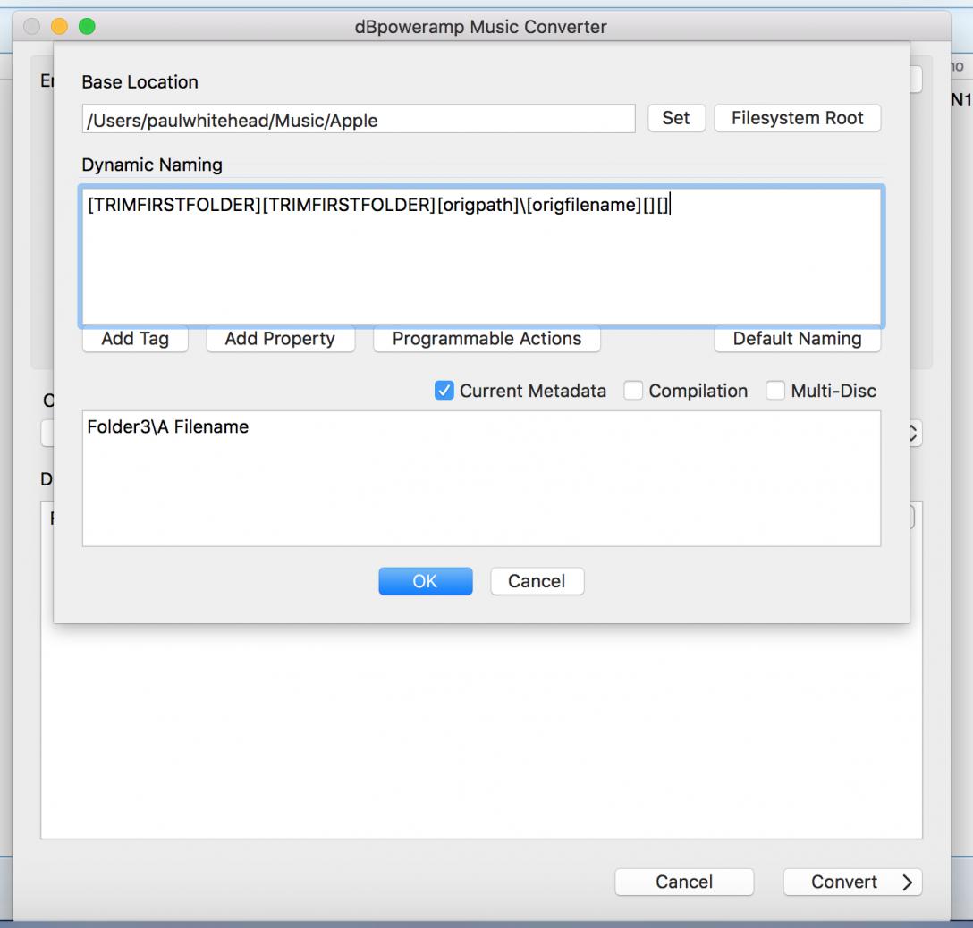

                  Re: Help needed to convert FLAC library to Apple Lossless
                  How do yo get to that screen. I get this..
Name:	Screen Shot 2017-12-24 at 18.13.26.jpg
                  Also in iTunes how can I select all effected files? I would have to go through each album in my collection to identify which shows wrong track information unless there is an easier way?
                    [ATTACH=CONFIG]1924[/ATTACH]
                    It is the same screen, just your software is for the Mac, mine is for Windows.
                    Also, you mentioned earlier Not sure what you mean by output to dropdown.
                    However, I can see the Output To dropdown, right in the middle of this screenshot

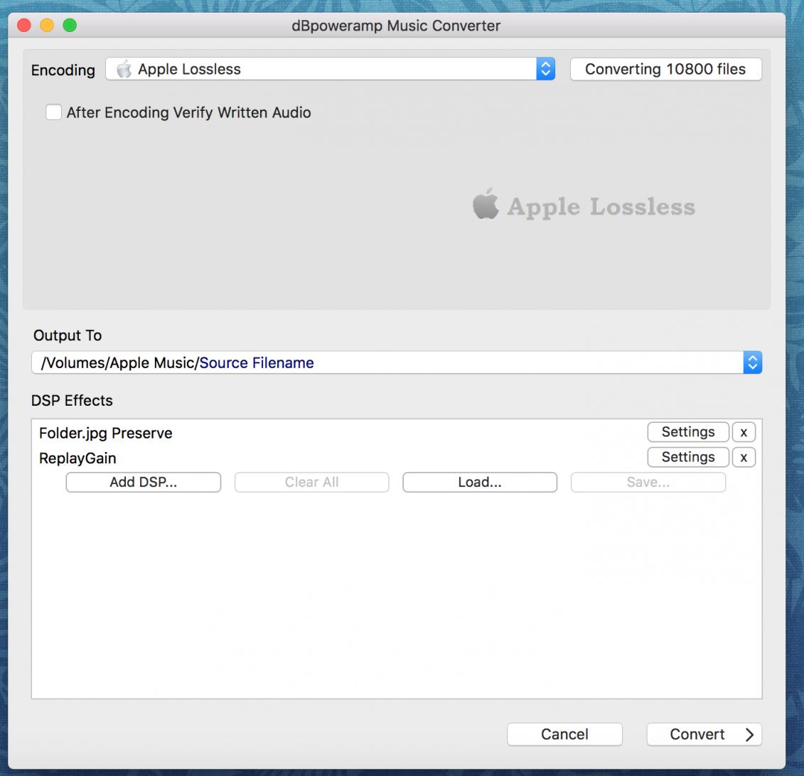

                              Re: Help needed to connect FLAC library to Apple Lossless
                              OK I have followed instructions (I think). Set up a folder to receive the test files called Apple. All files appear to have copied to lossless correctly now with all folders in place, however there seems to be a problem of additional sub folders being added to my Apple folder.
                              here is how I have music converter set up:
Name:	Screen Shot 2017-12-25 at 19.48.52.jpg
                              and here is how the files appear in the Apple file:
Name:	Screen Shot 2017-12-25 at 19.49.10.jpg
                              See how the extra folders...Paul Whitehead/(thats me)/Music/FLAC now appear
                              What am I doing wrong?
