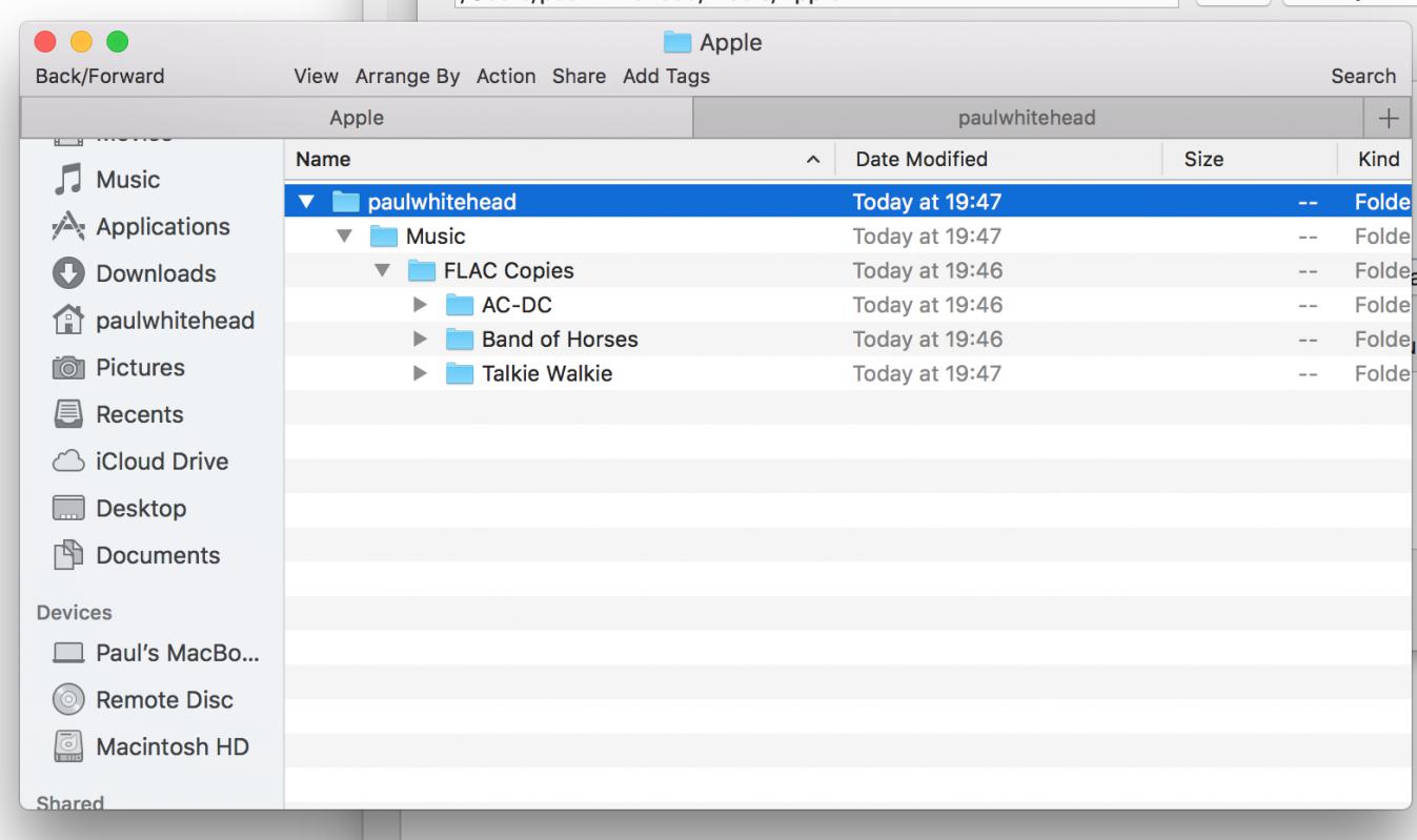

Re: Help needed to connect FLAC library to Apple Lossless
Plus, you could simply highlight and select all the artists files below "flac" folder in your example, then paste these directly into the APPLE directory you created. Then delete the "paul w", music, flac copies directories (which at this point will be empty). Then all your artist and album files in ALAC are underneath the upper level APPLE directory.Leave a comment:
try this for dynamic naming to get rid of the first 3 folders you don't want.
[TRIMFIRSTFOLDER][TRIMFIRSTFOLDER][TRIMFIRSTFOLDER][TRIMFIRSTFOLDER][TRIMFIRSTFOLDER][origpath][][]\[origfilename]Leave a comment:

OK I have followed instructions (I think). Set up a folder to receive the test files called Apple. All files appear to have copied to lossless correctly now with all folders in place, however there seems to be a problem of additional sub folders being added to my Apple folder.
here is how I have music converter set up:
and here is how the files appear in the Apple file:
See how the extra folders...Paul Whitehead/(thats me)/Music/FLAC now appear
What am I doing wrong?Leave a comment:
