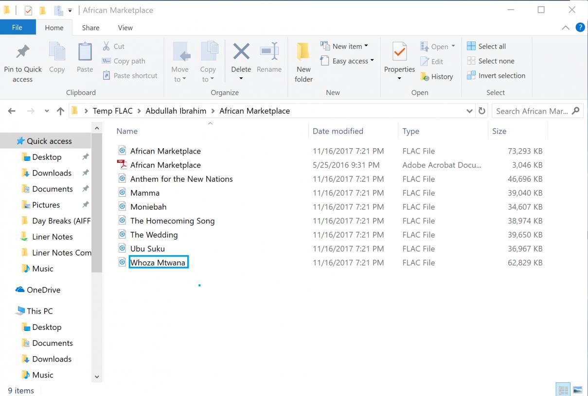

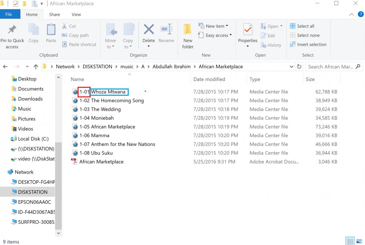

        Thanks, that worked and was really pleased with the DSP that moved my PDF liner notes to the target folders. However, there was one issue that I was surprised to see. Each of my AIFF files have a disc number-track number prefix (1-01 Title1, 1-02 Title2, etc.) but that didn't carry over during the batch conversion.
        Here is a screenshot of the AIFF files:
        and the converted FLAC files:
        I can run the Arrange Audio codec for the converted files, but it seems that disc number-track number prefix should carry over. Any throughts?

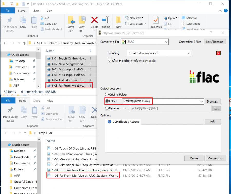

            So I ran a few more tests and understand what you may be asking.
            When I select my output location as Folder, the disc number-track number prefix is preserved:

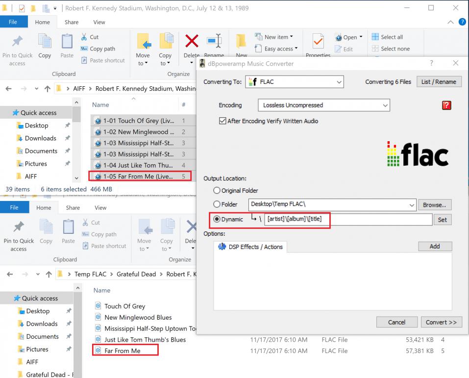

            When I select Dynamic, but the same location, the disc number-track number prefix is wiped:
            However, I really need Dynamic for a large-scale conversion or run I'll need to run the Arrange Audio codec afterward.

              If you use Dynamic Naming use Add Property >> Source Filename ([origfilename]).
                Re: Large Scale Batch Convert
                [ATTACH=CONFIG]1857[/ATTACH]
                Yes. That is because you only have [title], in the dynamic filename.

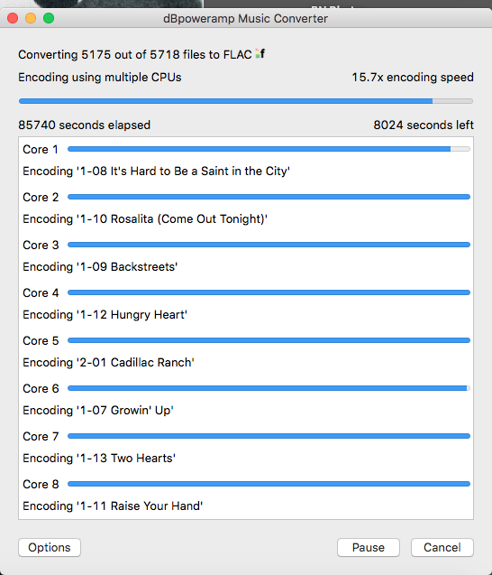

                        Nope, not resolved. I have been doing this for a few days. Using the OS X version, I dragged and dropped all artists beginning with A into an A folder, B into a B folder, etc. I'm using Batch Converter and the A artists took a good part of the day, but the B artists (5718 files) have taken ~20 hours and the end is in sight, but my Mac/NAS conversion is running painfully slow. Thoughts about reliabiiltiy (always the most imporatant) and improvements on speed- such as converting smaller batches? I'm thinking short term, abort once I see the Sringsteen has been converted, and then continue with all artists following Springsteen for the rest of the B (first name) artists.
Name:	Screen Shot 2018-04-04 at 5.29.54 AM.png
                          • 1915
                          Maybe it is no good idea to start the conversion for the files hosted on your NAS, because your NAS and/or your network is the bottleneck.
