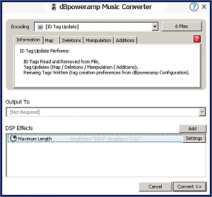

How may I crop all files to 5s length regardless of .EXT?
    This
    ignores the DSP effect!

    I guess that using "ID Tag Update" isn't the right way to go. "ID Tag Update" is just for updating the metadata of your files. I would try to use a converter to the same codec format as the source in combination with the maximum length (and the "ID Tag Update" if neccessary).

      Re: How may I crop all files to 5s length regardless of .EXT?
      That seems unlikely. It offers DSP effects.
      Thanks, but As I said, I want to process files regardless of .EXT.

        If you are using the ID Tag Update Utility Codec, then see here:
        dBpoweramp Codec Central: Utility Codecs
        ("Utility Codecs do not compress or read audio, but rather perform useful actions")
          Thanks. It seems then that the offer of DSP effects such as Maximum Length is a bug. I'll report it in a separate message. EDIT: Done https://forum.dbpoweramp.com/showthr...881*post170881
