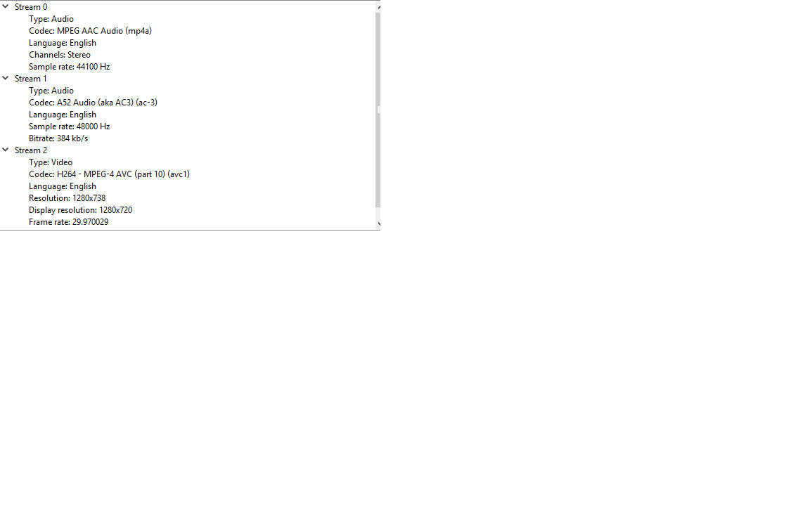

        I've located the file that is causing ' DMCFileSelector.exe' to crash. The file is a video file with an .mp4 extension. The video is around 4.74 GB in size. I have many other .mp4 videos that don't crash batch converter but they are a lot smaller. I've attached a screen shot of the video and audio codecs that are used by the video. I'm not sure if I've provided enough information. Let me know if I can supply anything additional. Thanks.
          • 45996
          Re: DMCFileSelector.exe crashes
          Are you able to upload it to dropbox?
