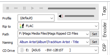

    For example, when I use the db Power amp CD ripper, I get a perfect outcome in terms of the the file structure, ie AlbumArtist\Album\TrackNum\ Artist - Title.

    Capture 1 attached is the CD Ripper settings which give a desired result.

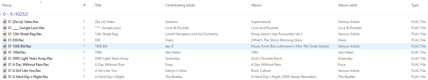

    Capture 2 attached gives the result provided by the batch converter, which is the total number of files, not sorted in folders to artist, with numerics 0 to 9, which I do not understand.

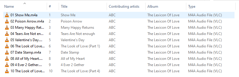

    Capture 3 is the desired outcome and is simply a pic of the source ITunes folder with the ALAC files.
