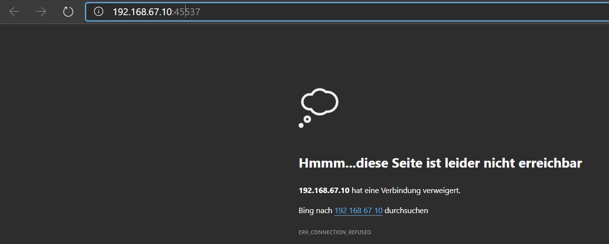

      Even with me, the asset is no longer accessible after a few hours. The service no longer seems to start because the start page with port 45537 is no longer available.

      If the Website page is down, the choice of player doesn't matter anymore - right?
      Stopping and starting the service does not change anything.
