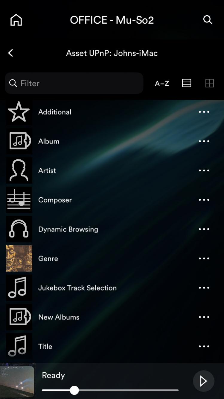

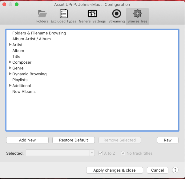

    As an example, I am posting two images... how the browse tree is currently configured in Asset (just an example, not my final configuration)... and how it appears in the Naim app, no matter what changes I make to the browse tree.

    Hi again John, I notice your iPhone screen shot has all the items in alphabetical order.
    New to Naim app 5.18 is an A-Z option, when in UPnP if you touch A-Z - the actual A-Z, not the A-Z line, you get a pop up menu that gives you a choice of Alphabetical or Server Default options.
    It doesn't match up your browse tree selection exactly, but its pretty close.

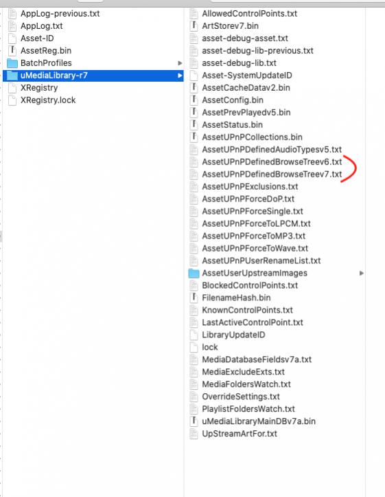

      However, I could see there are 2 different BrowseTree in the library : v6 and V7.
      One tree is the one I set in Asset, and the second tree (V7 if I am right) is the default tree.
      Unfortunately, the server choose the wrong one.
      I found a trick by copy/pasting the correct browse tree and renaming it with v6 (or V7, now I don't remember which one was correct)
      but each time I change the setup, I need to do this trick which is not convenient.

          I did a test:
          I removed the dbpoweramp folder in the library and started the config from scratch.
          At first, when I freshly reinstalled Asset, I only had the browseTreev7, no v6.
          then, when I set and saved my personal browse tree in Asset, it was saved under browseTreev6.
