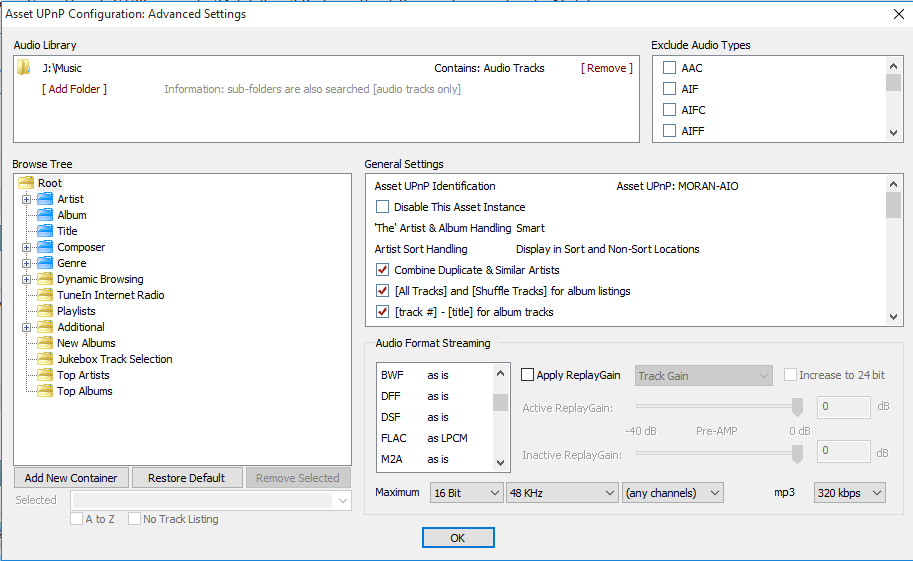

          Thanks for the replies guys (Mville I replied to you yesterday but it said it was awaiting "Moderator Approval" and hasn't appeared.) Basically you're quite right. In order to stream these hi-res flacs to my speaker I have to set the options in J River as PCM 16bit and downsample everything to 44100Hz and then they play fine. In Asset I've set the options attached in the picture. Ive tried FLAC as is, as WAV and as LPCM but none work. Is the frequency the problem in that the lowest I can set is 48KHz? Thanks for any help/advice you can give.
          DDJClick image for larger version

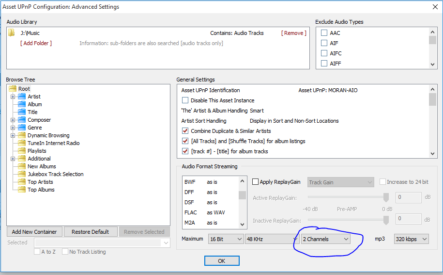

                The Digging worked! Had to set the maximum number of channels to 2 (as well as the other options as per the attached screenshot)
                Thanks again guys
                DDJ
                  Re: FLAC Problem
                  Remember also, that these maximum settings (bits, frequency and channel) in Asset are global settings.
                  You are also able to use the Settings Override (Control Point Specific) options [StreamMax16Bit], [StreamMax48KHz] and [StreamMax2Channels], where you can set these settings by a known control point name i.e. your Bose SoundTouch ST20.
