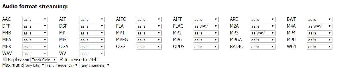

                Now I also want to introduce you to the transcoding configuration feature in Asset - you can allow Asset to unpack the compressed lossless format of FLAC (& ALAC) and serve it as WAV. It means it can take up less space as compressed lossless, be easier to manage from a metadata standpoint, but be presented to your playback endpoint as bit-perfect uncompressed lossless files.
                So this section of the Asset configuration becomes:

                What is the Playback Endpoint you are serving?

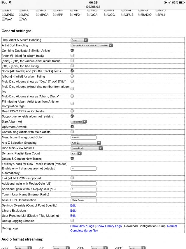

                            One other question....now that I am up and running, I have a fairly large number of compilation albums where I have listed the artist as "Various Artists".. With the first scan, they all appeared under the "V" section of artists/albums. I rescanned the library to update everything and now only two albums appear. I suspect this has something to do with configuring Asset, but not sure where to look. Can you help?

                              Re: Raspberry Newbie needs help
                              Are they marked as Complilations with the 'Compilation' flag set to true?
                              If so, look under Complilations, which is a separate folder in the tree structure.
                              Otherwise the rest is down to Configuration settings in Asset, plus how you have tagged your tracks.
                              Have you used an Album Artist, in addition to Artist?
                              This is my heavily customised configuration
                              You can also find my Tree library in the Shared folder, along with some customised icons for the folders.
