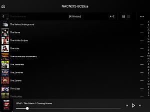

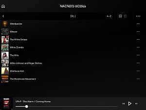

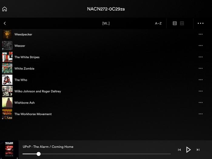

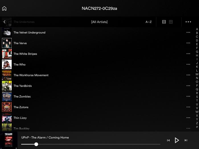

    I have just purchased the full version of Asset running it on a Qnap 453-A and have come across a annoying issue regarding the smart setting.
    All is well when viewing the Artist through the A B C selections down the left hand side, i.e. The Who are found under W and shown as The Who.
    When I look for through All Artists The Who are found under T not W
    The most annoying thing is everything is displayed correctly in Linn's Kinsky App.
    Is this an issue with the Naim App and if so is there a fix?.
    Thx in advance

          Thanks for the replays,
          I do think it's something with the Naim app as every App I have tried including Arcam, Bubble works fine as does the alphabetical search as in the attached screen shots.
          I have posted on the Naim forum but TBH only expect the usual party line response on it's the tagging.
          I looked at the tree but there seem to be some options missing (++Title).
          I will use the Value option as this works as intended.
