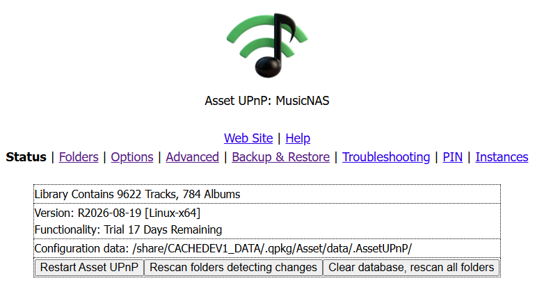

    I have Asset UPnP running on a QNAP TS-264.
    I was running the QNAP trial version R2026-07-29 and have now purchased Asset UPnP Premium.
    I downloaded the QNAP Premium R2026-08-19 QPKG from my registered “Your Downloads” page and followed the instructions in the sticky “Upgrading between beta/trial/registered versions of Asset UPnP”.
    I did not uninstall the trial. I manually installed the registered QPKG over the existing installation using QNAP App Center. During installation App Center showed Asset as “Updating”, and the installation completed successfully. I then restarted the QNAP as instructed.
    Asset has successfully updated to:
    Version: R2026-08-19 [Linux-x64]
    but the Status page still shows:
    Functionality: Trial 17 Days Remaining
    The existing configuration and library have been preserved and Asset otherwise appears to be working normally.
    Could you please advise how I can get the installation to recognise the Premium registration without uninstalling Asset and losing its existing configuration?

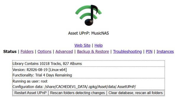

          I followed the workaround exactly:
          • exported configuration
          • uninstalled Asset trial
          • manually installed the registered QNAP R2026-08-19 QPKG
          • did not yet import the configuration
          The install completed successfully, but Asset still shows:
          Functionality: Trial 4 Days Remaining
          The version is R2026-08-19 [Linux-x64].
          So unfortunately the uninstall/reinstall workaround has not converted the installation to registered status either.
          Please advise next step, as the trial now has only 4 days remaining.
