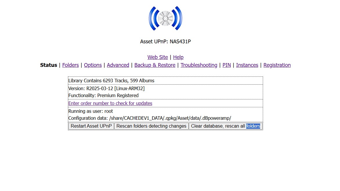

      Hi Spoon, I have Asset UPnP on PC but just for the configuration setting, how do I get configuration setting from the NAS? I only seem to open up Asset and get this - Click image for larger version

        • 46150
        That is it, click on instances, then you can edit them.

          Brilliant, never looked at 'Instances' so I don't need Asset on the PC? Just tweak through this setup page via Asset app on NAS to configure Asset UPnP NAS431P

            • 46150
            Yes Asset on the PC is not used for you if you have a NAS.
