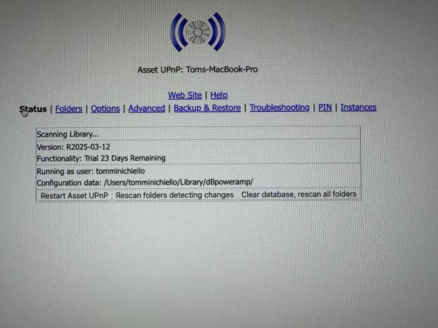

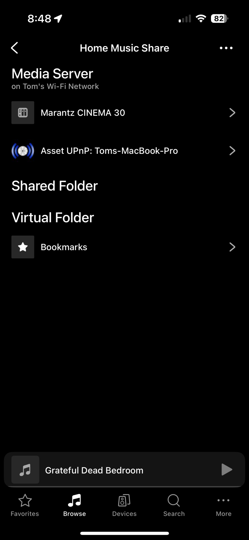

    Here are the Asset screens. Again, not sure what's going on, if anything
    Also, to play the music on the external drive attached to the mac, I just click on the track inside the folfer once and it play on the computer
    If i click on it twice, it's opens up the album in foobar (which I also installed)
    On the WiiM player, Asset shows up, (picture here - black background) but nothing in it

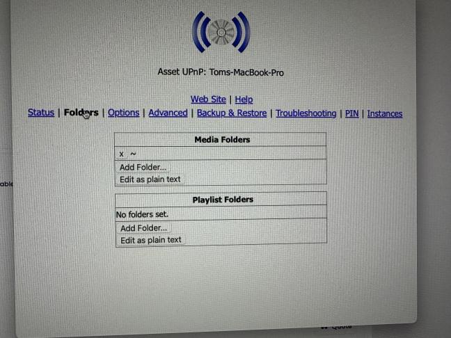

      • 46114
      On the media folders page, click Add Folder and browse to the location of your music and click add.
      • sculen
        • Jun 2025
        • 96
        Tried that and it doesn't have the external drive anywhere in the choices. So I can't get to it and click add.
          • 46114
          If you open Finder, you should be able to locate and browse the external drive.
          • sculen
            • Jun 2025
            • 96
            Correct. No issue with that. What I can't seem to grasp is how do I get Asset to connect to/scan the music files on that external drive? So then it can load/play on the WiiM. Within Asset, there does not appear to be a way, although I'm sure there is and I just don't know how.

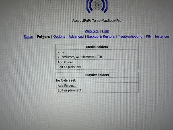

                Please go to folders, click on the top add folder button and do a screenshot, The list of possible folders may be fairly long so you may have to scroll for multiple screenshots

                  I did suggest Upplay, but given the WiiM Home App can see Asset there's no local testing needed.

                      #25
                      It took a while, but somehow I was able to locate the folder where the external drive was. Now what?
                          Hopefully when it's finished Scanning Library your content will be available in the WiiM Home app/StreamMagic.
                          AssetUPnP documentation: https://www.dbpoweramp.com/Help/AssetUPnP/advanced.html
                            • 46114
                            #28
                            Correct, wait for it to finish scanning the library (reload that page occasionally to see how it gets on), then you are ready to serve music to a network player.

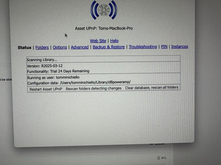

                              Thanks!! Music is now available and playing. Great!! Question. Noticed that I ripped one CD in the wrong genre. If I go back and re-rip in the right genre, do I need to rescan? Or will it automatically pick up the new rip and ignore the old one?
                              • sculen
                                • Jun 2025
                                • 96
                                #30
                                Also, how do you know when it's completed scanning? It still says "Scanning Library"
