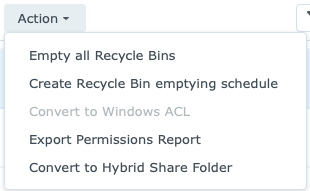

                I'm a new user of Asset UPnP but have been using Synology NAS for some years. I have a shared folder that has my media library, Iand had to add access permisions to this to enable Asset UPnP to use it. This is on DSM 7.2.

                If that doesn't work then go to Control Panel and the Shared Folder page. Select the shared folder you're interested in. Click the Action button and see if the folder has Windows ACLs enabled, or not. Yoiu can see my folder has been converted to use Windows ACLs.
