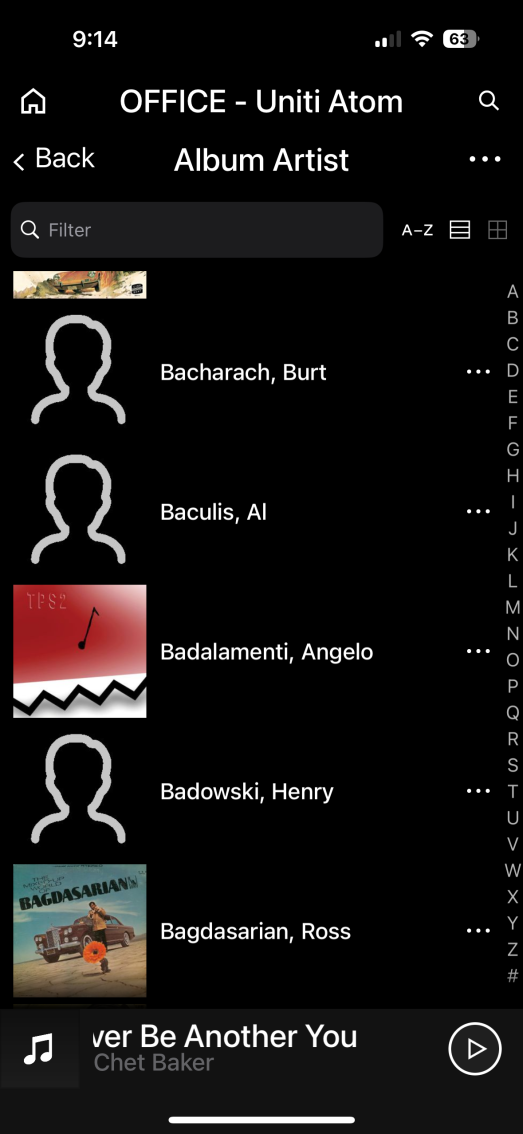

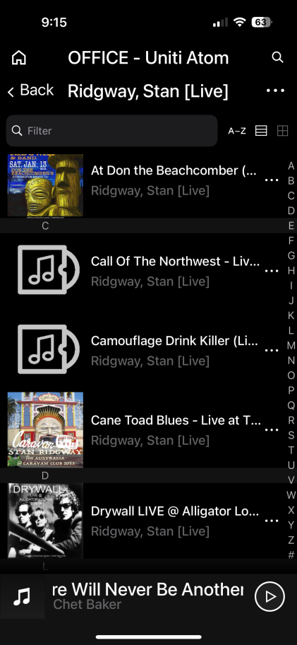

          Thanks for this... unfortunately, the issue remains. Here are two views from the Naim app:
          - Album Artist view (missing some of the images)
          - A view of an Album Artist entry (missing some of the album artwork images)

          As mentioned in my earlier post, all artwork is embedded and all of it displays without issue in the previous version I am using (R2023-05-15).
