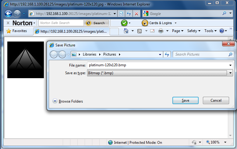

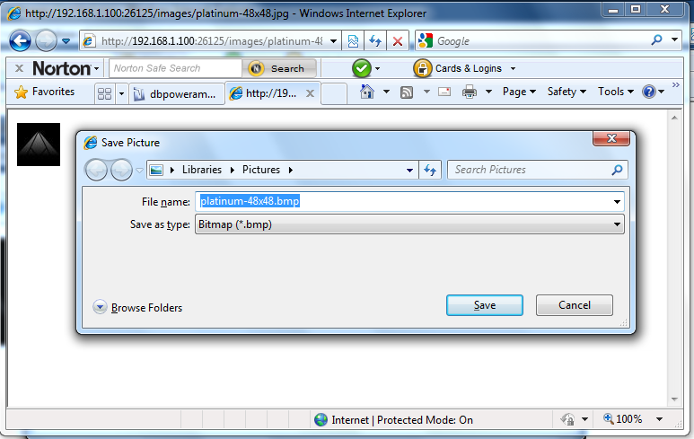

            Re: Asset UPnP on Bravia TV setup problem
            >>/images/platinum-48x48.jpg
            These are JPGs, atleast in our source code they are and they are passed out as is. You could paste the link into Internet Explorer then save as the image and it will be jpg.
            • AndrewFG
              • May 2010
              • 59
              #21
              Sorry, you may think that is a JPG in your source code. But in Internet explorer it is served as a BMP. See attached screenshots. Or test it yourself...
