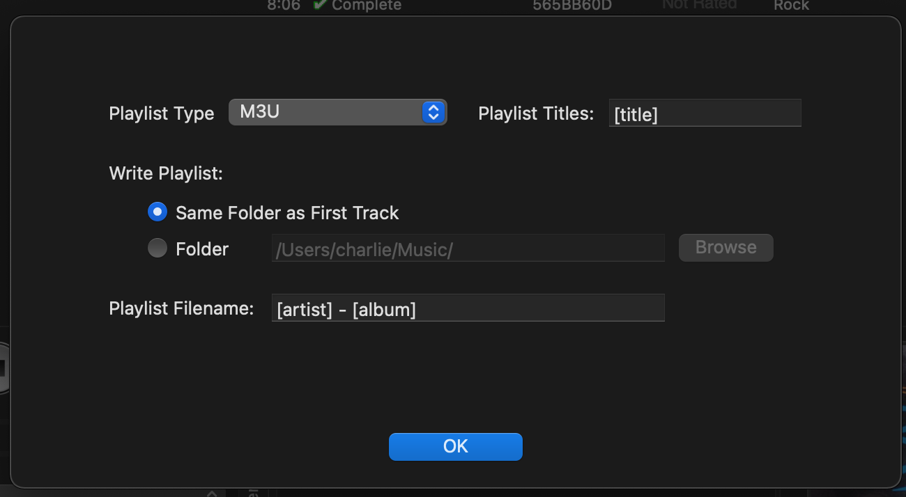

    Are you running CD Ripper on a Mac? What options have you set in the Playlist Writer DSP?
    I ask because I've just tested CD Ripper for windows (R17.7), using the default values for the Playlist Writer DSP:
    The resulting m3u playlist, has relative paths and I can open and play it in all my audio players/software.
    If possible, can you rip a popular CD in CD Ripper with default options, and post the resulting m3u playlist contents here?

    Hi simbun and mville. I appreciate your ongoing assistance here.
    mville - I am using dBpoweramp on a mac (os Big Sur) and here is a picture of the Playlist writer settings. They are exactly as you have them on your system:

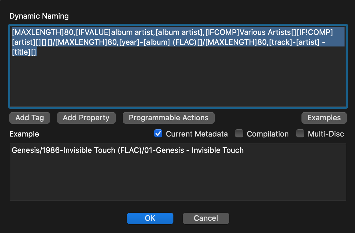

    Hmm... the Invisible Touch playlist looks ok to me. Can you copy and paste it's contents here along with your Naming string?

    Naming string:
    [MAXLENGTH]80,[IFVALUE]album artist,[album artist],[IFCOMP]Various Artists[][IF!COMP][artist][][][]/[MAXLENGTH]80,[year]-[album] (FLAC)[]/[MAXLENGTH]80,[track]-[artist] - [title][]
