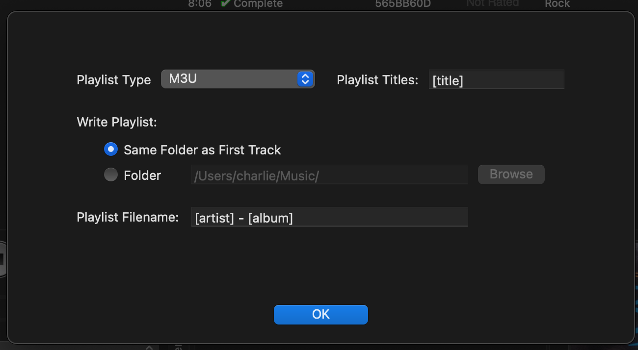

                Are you running CD Ripper on a Mac? What options have you set in the Playlist Writer DSP?
                I ask because I've just tested CD Ripper for windows (R17.7), using the default values for the Playlist Writer DSP:
                The resulting m3u playlist, has relative paths and I can open and play it in all my audio players/software.
                If possible, can you rip a popular CD in CD Ripper with default options, and post the resulting m3u playlist contents here?

                  mville - I am using dBpoweramp on a mac (os Big Sur) and here is a picture of the Playlist writer settings. They are exactly as you have them on your system:

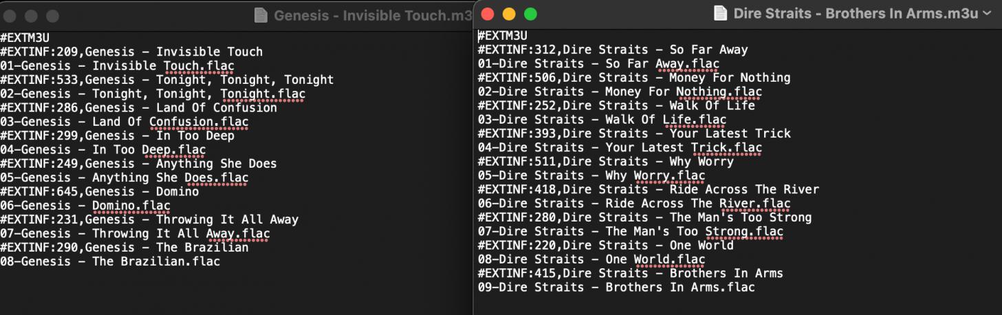

                  I ripped Dire Straits "Brothers in Arms" with the default settings and the m3u file worked perfectly. Weird. I then immediately put in Genesis "Invisible Touch" and it ripped accuraclty but the m3u file will not work. I have no explanation as to why as I literally took out one CD, put in the next and hit "rip". Both m3u files are here and look identical to me:
Name:	M3U side by side.jpg
ID:	294665Click image for larger version

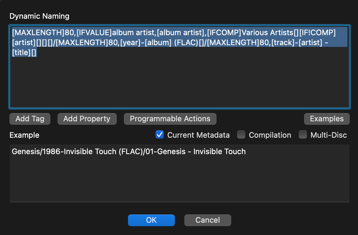

                  Simbun- I renamed a few interntet tracks as suggested and made a successful playlist in Kid3 which played as expected. I then took a few tracks from a ripped CD I made, renamed them and they will not play. I also tried removing the EXIF lines from a ripped playlist but it had no affect.
                  I also tried ripping an m3u8 file but had the same results.
                  Maybe my naming scheme is screwing it up? Would not explain the Dire Straits above.
                    Re: Newbie Playlist Question
                    Hmm... the Invisible Touch playlist looks ok to me. Can you copy and paste it's contents here along with your Naming string?
                      Is this what you were referring to?
                      m3u file contents:
                      *EXTM3U
                      *EXTINF:209,Genesis - Invisible Touch
                      01-Genesis - Invisible Touch.flac
                      *EXTINF:533,Genesis - Tonight, Tonight, Tonight
                      02-Genesis - Tonight, Tonight, Tonight.flac
                      *EXTINF:286,Genesis - Land Of Confusion
                      03-Genesis - Land Of Confusion.flac
                      *EXTINF:299,Genesis - In Too Deep
                      04-Genesis - In Too Deep.flac
                      *EXTINF:249,Genesis - Anything She Does
                      05-Genesis - Anything She Does.flac
                      *EXTINF:645,Genesis - Domino
                      06-Genesis - Domino.flac
                      *EXTINF:231,Genesis - Throwing It All Away
                      07-Genesis - Throwing It All Away.flac
                      *EXTINF:290,Genesis - The Brazilian
                      08-Genesis - The Brazilian.flac
                      Naming string:
                      [MAXLENGTH]80,[IFVALUE]album artist,[album artist],[IFCOMP]Various Artists[][IF!COMP][artist][][][]/[MAXLENGTH]80,[year]-[album] (FLAC)[]/[MAXLENGTH]80,[track]-[artist] - [title][]
