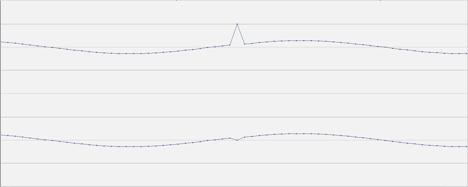

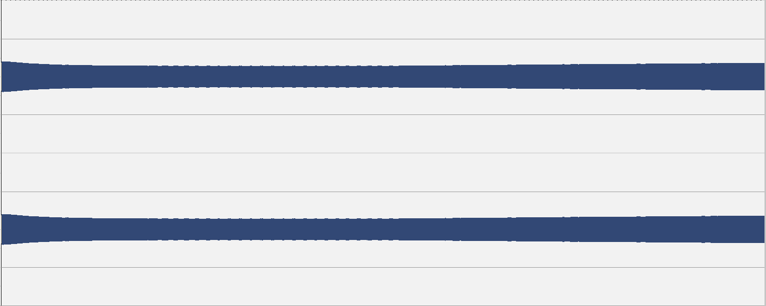

    With Stereo Tool VST2, I just applied it on a WAV file containing a sine wave at -40dB (downloadable here).
    This is what the output looks like when processed with Sound Forge:
    This is the output with dBpoweramp (same settings) - notice artefacts in audio and extra silence added to beginning:
    Zoomed-in view of the regular artefacts:
    If there's anything you'd like me to test, do let me know.
