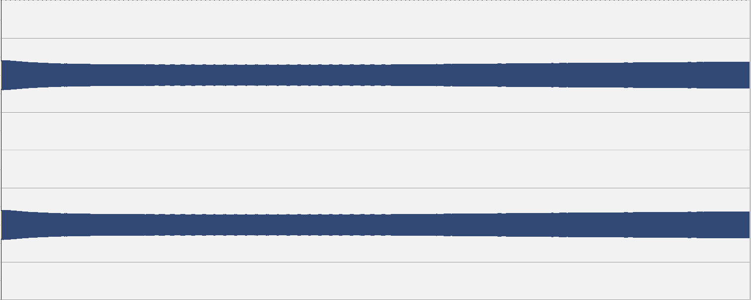

        Stereo Tool VST2 works for me, output appeared OK. Any specific content that you tried it on? File format / sample rate / bit depth?
        Everything I've tried is WAV / 16-bit / 44100Hz.
        With Stereo Tool VST2, I just applied it on a WAV file containing a sine wave at -40dB (downloadable here).
        This is what the output looks like when processed with Sound Forge:

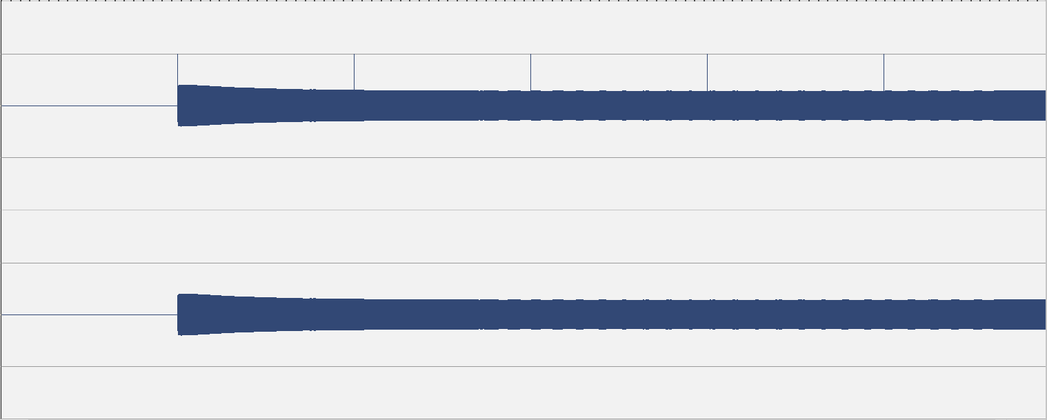

        This is the output with dBpoweramp (same settings) - notice artefacts in audio and extra silence added to beginning:

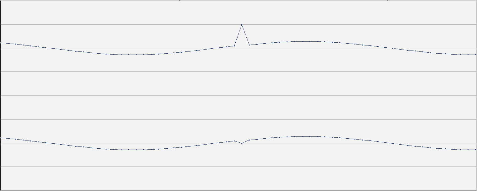

        Zoomed-in view of the regular artefacts:
        If there's anything you'd like me to test, do let me know.
