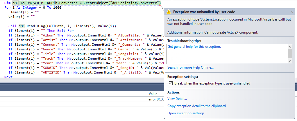

    I've been using dMCScripting for years on my site, but now that I'm moving to a 64-bit host, I'm having problems with it.
    Basically, I have Visual Studio 2015 developing on Widows 10. When developing local I get "Cannot create ActiveX component" whenever I try to create the scripting object. I have verified that it appears as a COM reference, that it's registered with regsvr32, that it appears in regedit and that is is the 64-bit dll.
    I don't get the error on the Server 2012 R2 box, but I am not getting back any tags with ReadIDTag so I'm trying to troubleshoot locally. I have tried 14 Ref, 14.4 Ref, 15.0 Ref and now 16.0 Ref.
    Simple code:

    Error message in attachment.
    BTW, before you suggest it, VS 2015 doesn't have the option to build for x64, only "Any CPU".
    Any help would be appreciated.

    We only have VS 2013, when creating a Windows forms application, it does have the x64 option under: Settings >> Build >> Platform Target.
      dBpoweramp Guru
      • 4015
      Re: VS2015, Vb.Net, &quot;Cannot create ActiveX component&quot;
      I am using Visual Studio 2015 on a Windows 8.1 Pro x64 PC and have a dMCScripting project working fine.
      In my project, I have set a reference to dMCScripting 1.0 Type Library and the Target CPU is set to x64.
