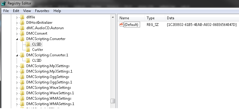

          No, I created a small VB script to (using the exampels) to create a dMCScripting.Converter object. After succesfully getting the WshShell object and assigning it to WshShell as in the example, CreateObject with dMCScripting.Converter failed. The unhandled exception occurred stating "Cannot create ActiveX component". This is from within VS being run as Administrator in debug mode.
          Also, my registry currently has the following entries:
          <<Update>>
          I should add that these registry entries are under HKCR but I also attempted to create an identical entry under HKCU for dmcscripting.converter while troubleshooting yesterday - but no breakthrough.
