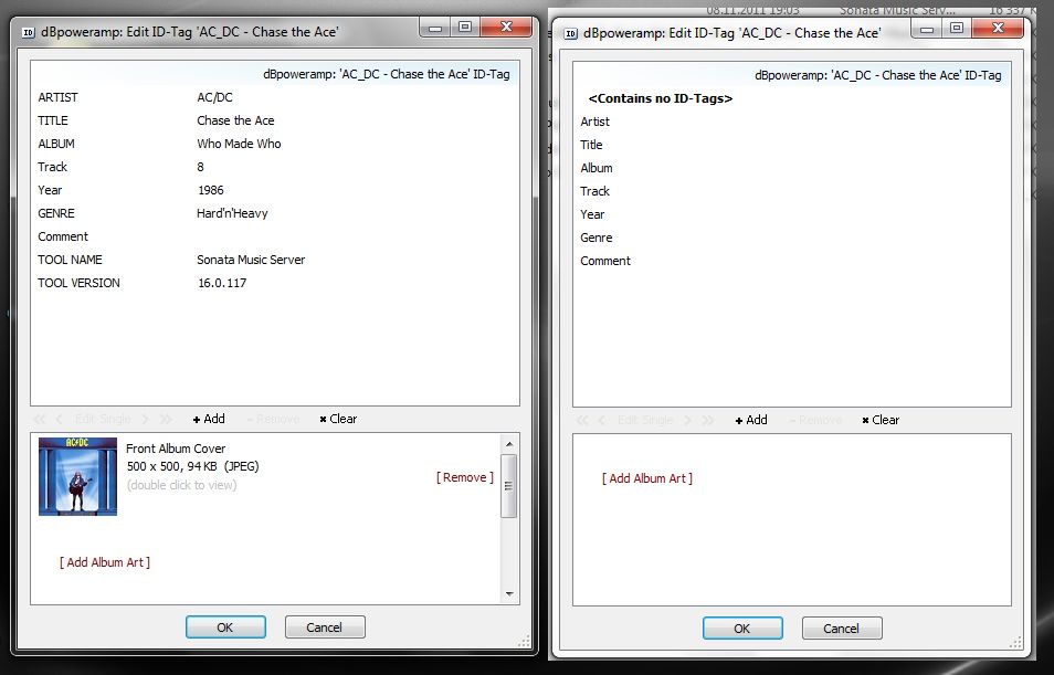

      Left: Logged in as User 1 (all infos displayed)
      Right: Logged in as User 2 (no infos available)
      And that's exactly the problem that not both accounts show metadata, but they're supposed to (?).
      I use Sonata Server, which is based on JRiver MC as Music-Server/Player, both users have access to that software and should be able to see/play all songs. Because of "missing" metadata, user 2 doesn't have access to many files, because of missing metadata, a given FLAC can not be recognised as containing music of artist XY, therefore it is ignored by the Music Server.
